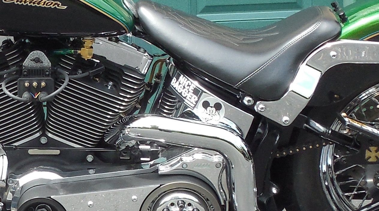

Will be moving the coil to the spot currently occupied by the horn. Figure there is no real gain from that except cosmetics, but I like the looks and wonder why MoCo didn't do it that way from the factor. I have seen a couple of builds where the fake seat tube is removed, and again, from a purely cosmetic perspective, I like that look. It unclutters the space between the rear cylinder and the oil tank, and affords better visibility of both. What I don't want to do is remove a part that serves a real structural purpose, so I am un-decided. It looks like it is soft mounted at the top, which would seem to imply that it is not loaded .
Who has removed theirs? Were there any adverse effects?

I removed the seat post/ coil bracket a few years ago. No adverse effects. I am a cowbell horn hater, I like the coil in that spot much better.

I removed the seat post on my Night Train several years ago and have had no issues. Removing it does help with the air flow around your rear cylinder. Looks cleaner too.

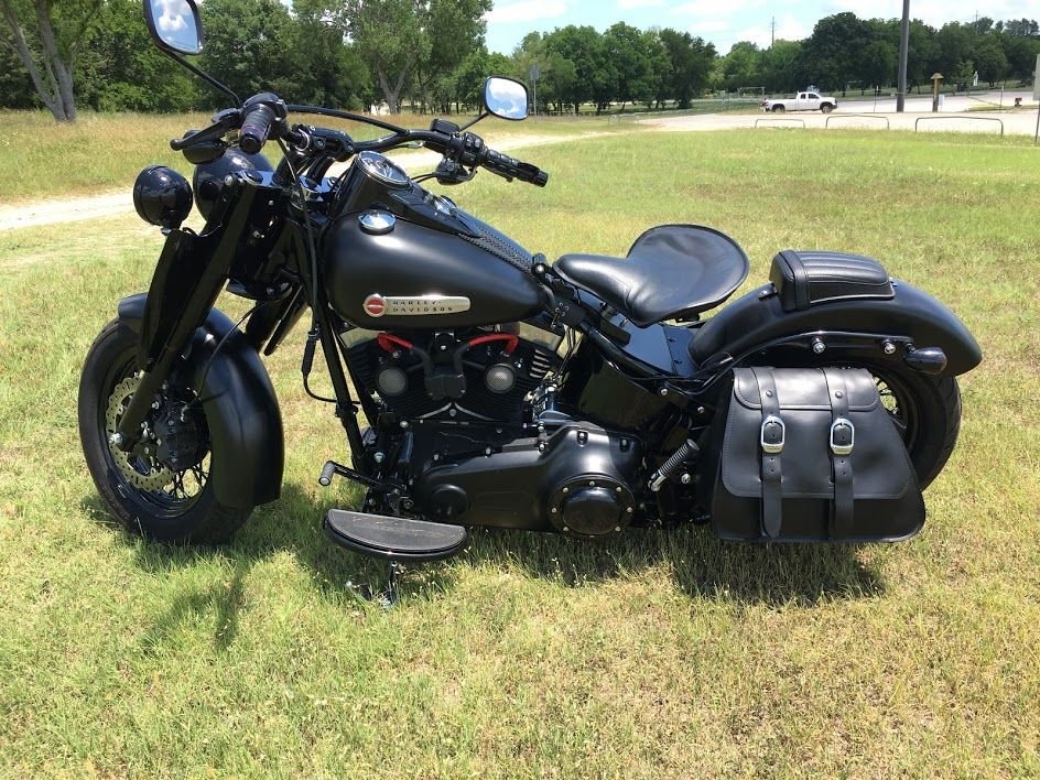

When you remove that 'fake' seat post piece, you'll see that there's no
way it would be for any 'structural' type support. It's just too small of
guage metal. I removed mine in 2013, no issues since. Here's a pic:
hth,
T.

Thanks! It is a Harley Davidson Rocker-C bag/mount.. It is a 'quick detach' version
They are extremely hard to find these days. I only run the left-hand side one.
I have a HD toolbox on the other side.... Here is 'that side' picture.
Here's a pic of the mount, it's kind of hard to see, but it follows the frame/swingarm and
the passengers pegs mount to it.
hth,
T.

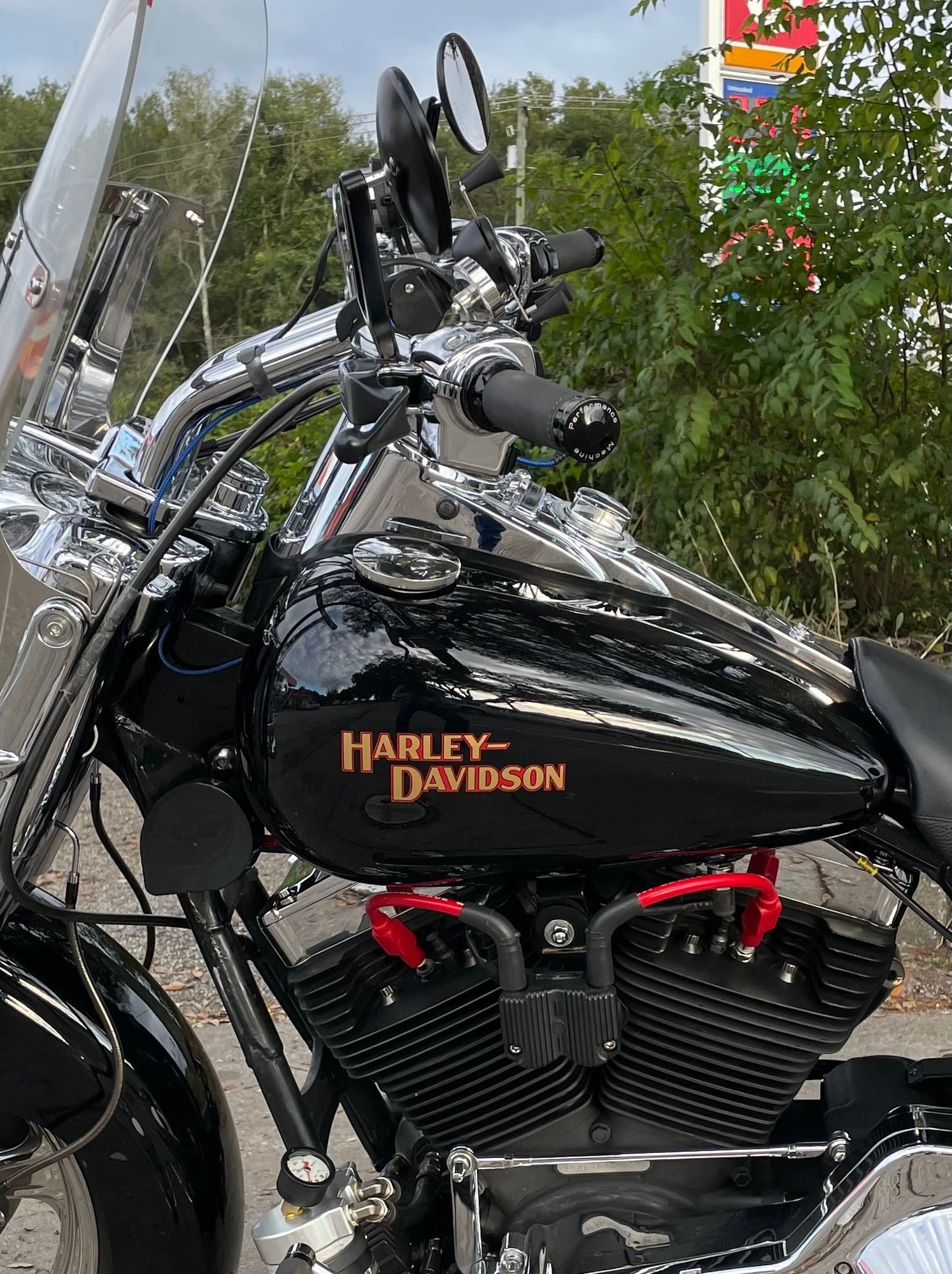

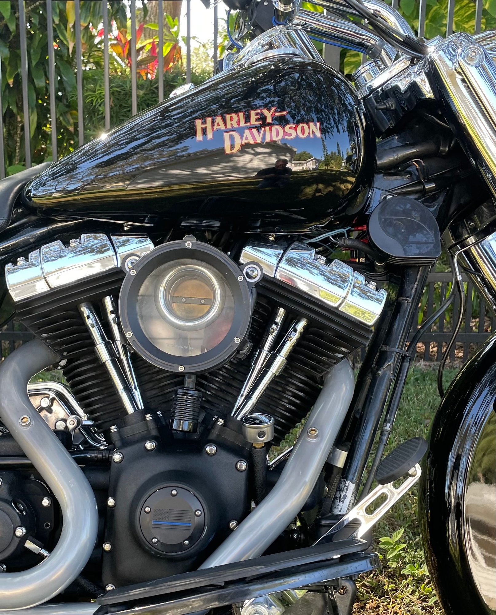

I relocated coil on my 2002 Road King. I relocated horns to the tank mounts using a 420Hz and 520Hz
Old Dec 28, 2021 | 07:05 PM
BlackBastard's Avatar
BlackBastard
Joined: Jul 2007
Posts: 170
Likes: 51
From: Clearwater, FL
Right side to show horn relocation
