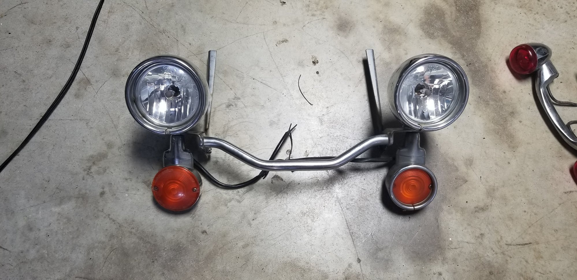

I'm wanting to add the passing/driving/aux lights (everyone calls them something different) & lightbar to my 02 Fatboy, I found a set local from an 05 Electraglide for a good price, I know the bar wont fit, but how about the lights themselves? Will the wiring be plug and play or should I hold out for a factory set for a softail?

The '02 softails and '05 touring bikes use different mounting brackets (#58082-02A v #68712-94A) and different passing lamps (#68671-69D v #68846-98C). While it's possible, I wouldn't bank on them having the same wire connectors...
Since the lamps and mounts are different, you might be better served (read: need less modifications to make it work), to wait until you find a good early twin cam softail set-up...
If someone has first hand experience with this mod, hopefully they will chime in...

I have these off of my 03 Heritage. You're welcome to have them, just cover shipping from Cypress, TX. Buy the screws and spacers from HD and they'll bolt right on.
