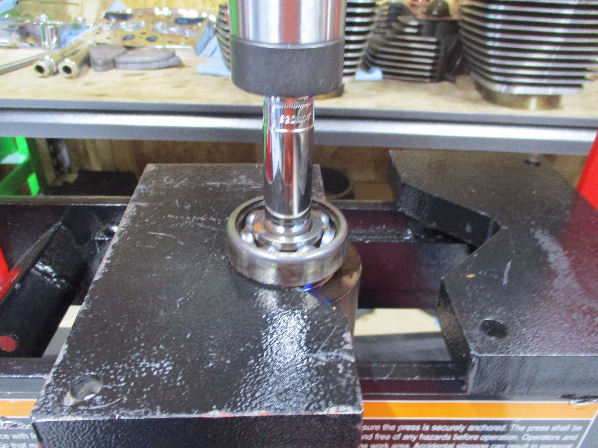

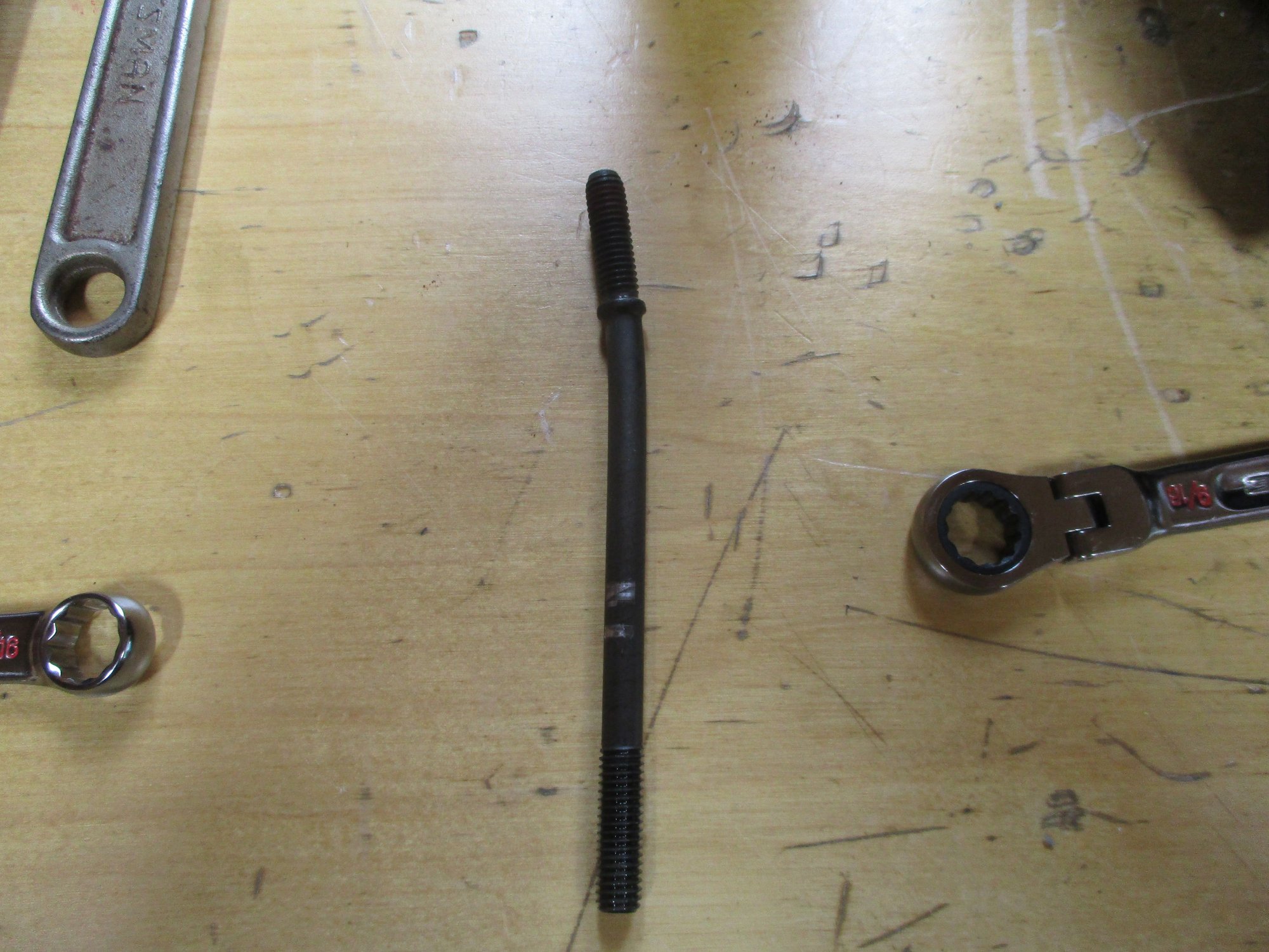

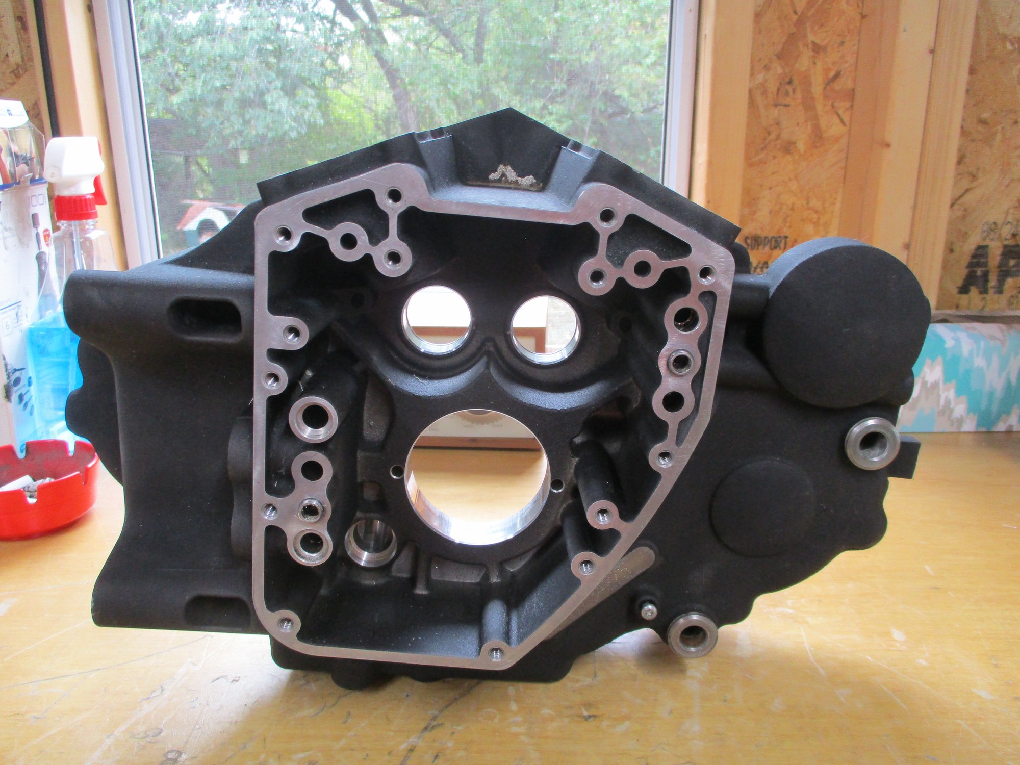

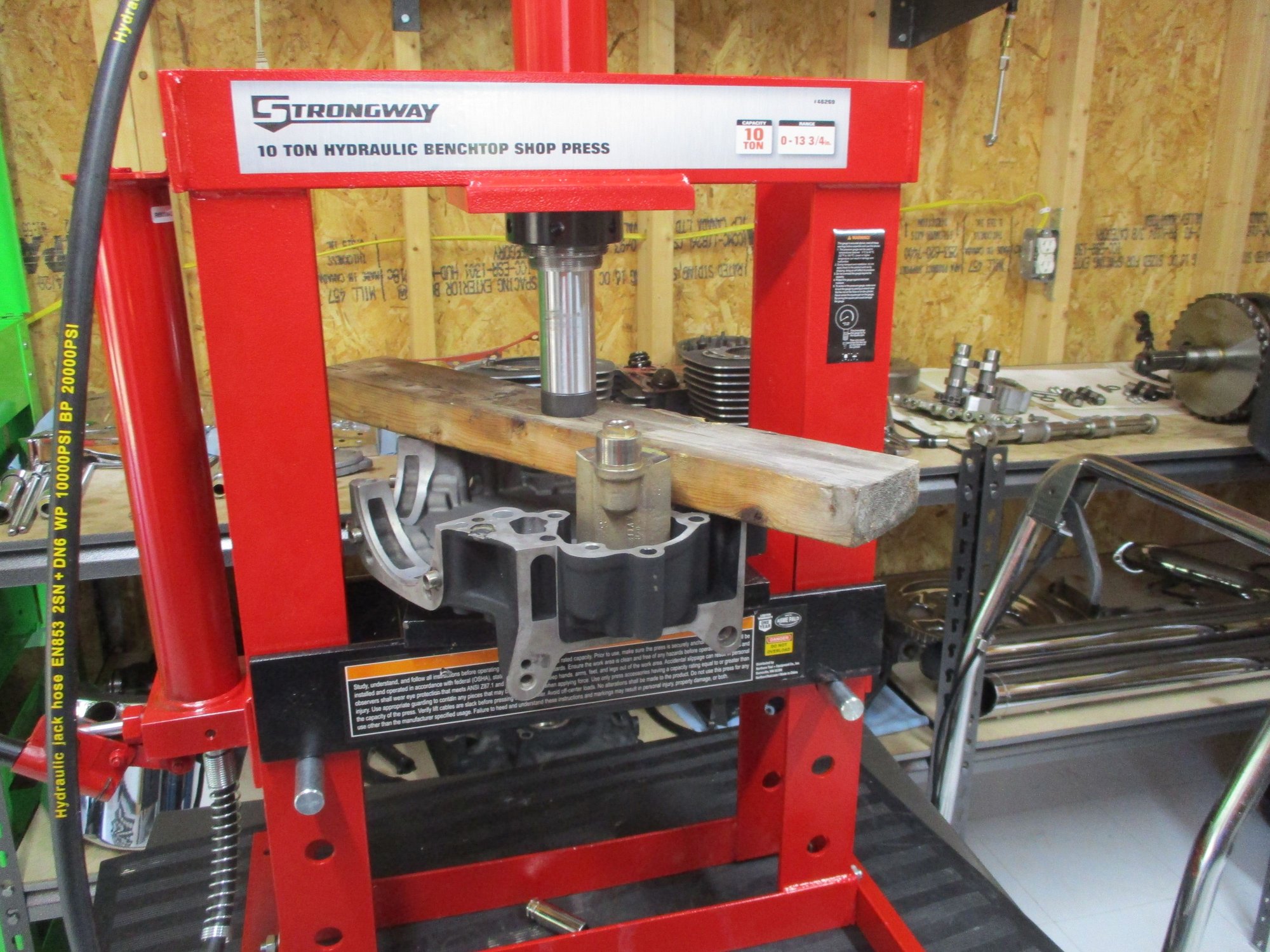

Well had my first screw up. Pulling the bearing out of the left side casing I dropped the casing as I was pulling it out of the press. Bent the hell out of the cylinder stud. So now we get to pull the studs and replace all with fueling studs.

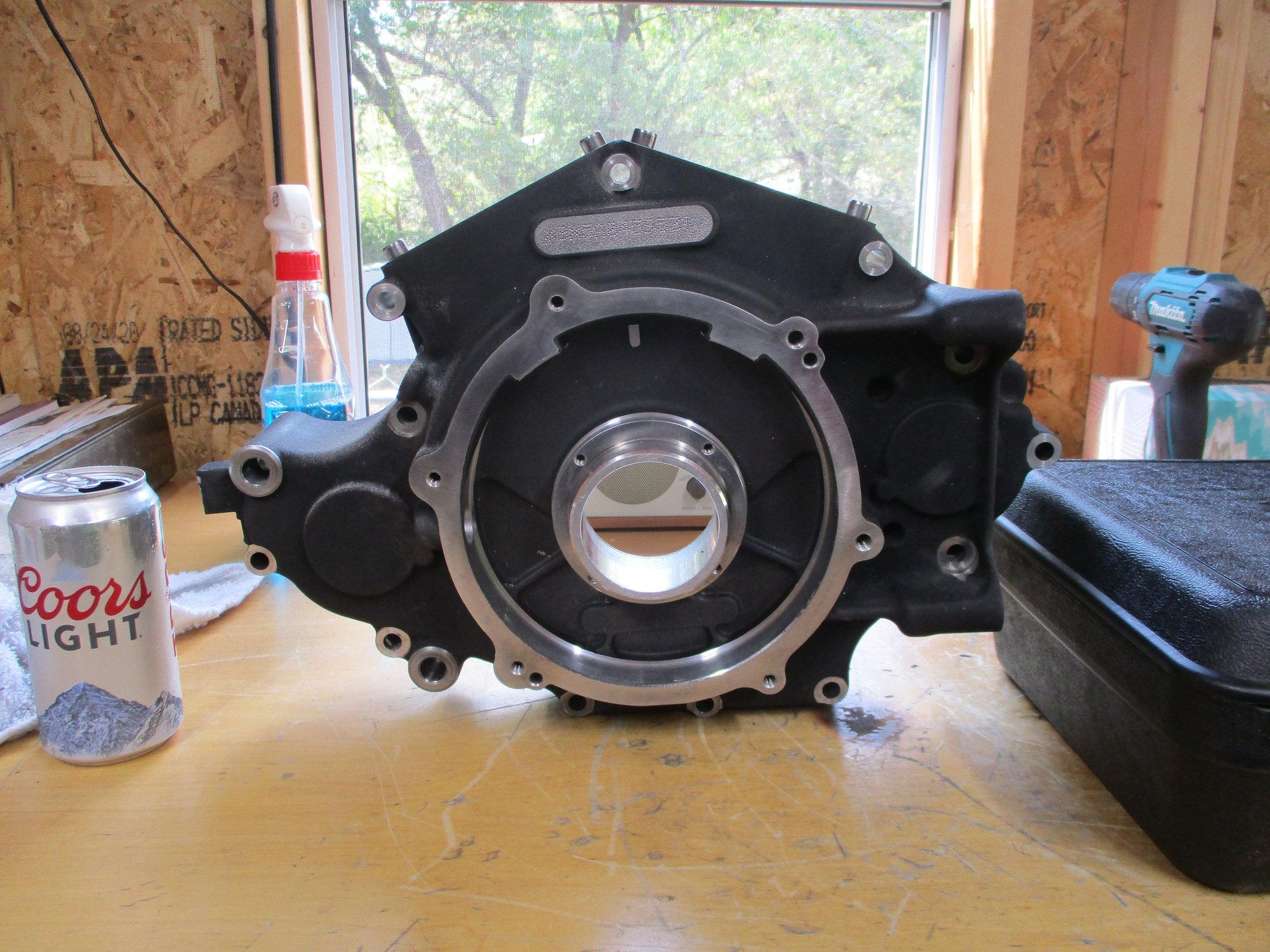

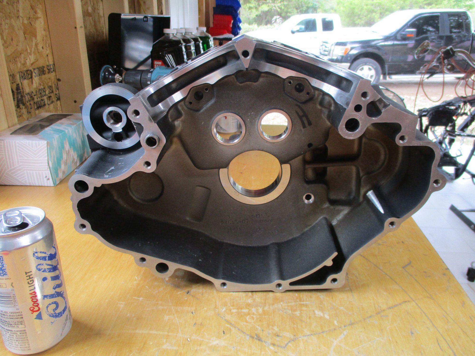

Take it to work and blow it out. Then bring it home an dip it in the clean tank. All threads chased. All mating surfaces cleaned. Took a lot of work but believe in the long run it will be worth it.

I need some help. Balance shafts are locked in to Inside bearings. Would like to remove balance shafts and replace inside bearings No clue on how to do this. Checked out manual and found nothing. Help please.
Old Sep 17, 2022 | 05:00 PM
sonny4's Avatar
sonny4
Joined: Feb 2022
Posts: 848
Likes: 403
From: Oklahoma
Got her done. Yes bearings were toast after 100. thousand miles. 2007 and beyond twin cam balancer is different from 2006 and below. If your looking into doing this job let me known. Just PM me. If your looking into cams and compression bull follow the crowd. You want a strong bottom end that will support a build follow me on my journey.

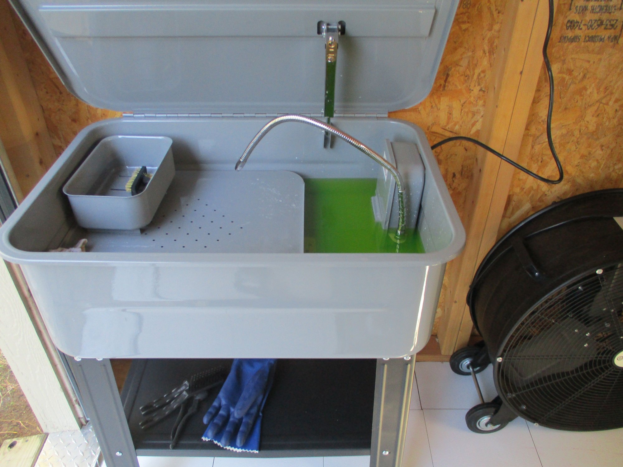

Caved in and bought a parts washer from Harbor freight. Pics to follow
Old Nov 1, 2022 | 05:12 PM
sonny4's Avatar
sonny4
Joined: Feb 2022
Posts: 848
Likes: 403
From: Oklahoma
Well here it is. Works great. One gallon of cleaner added and is just about the right mixture.Lovin it.

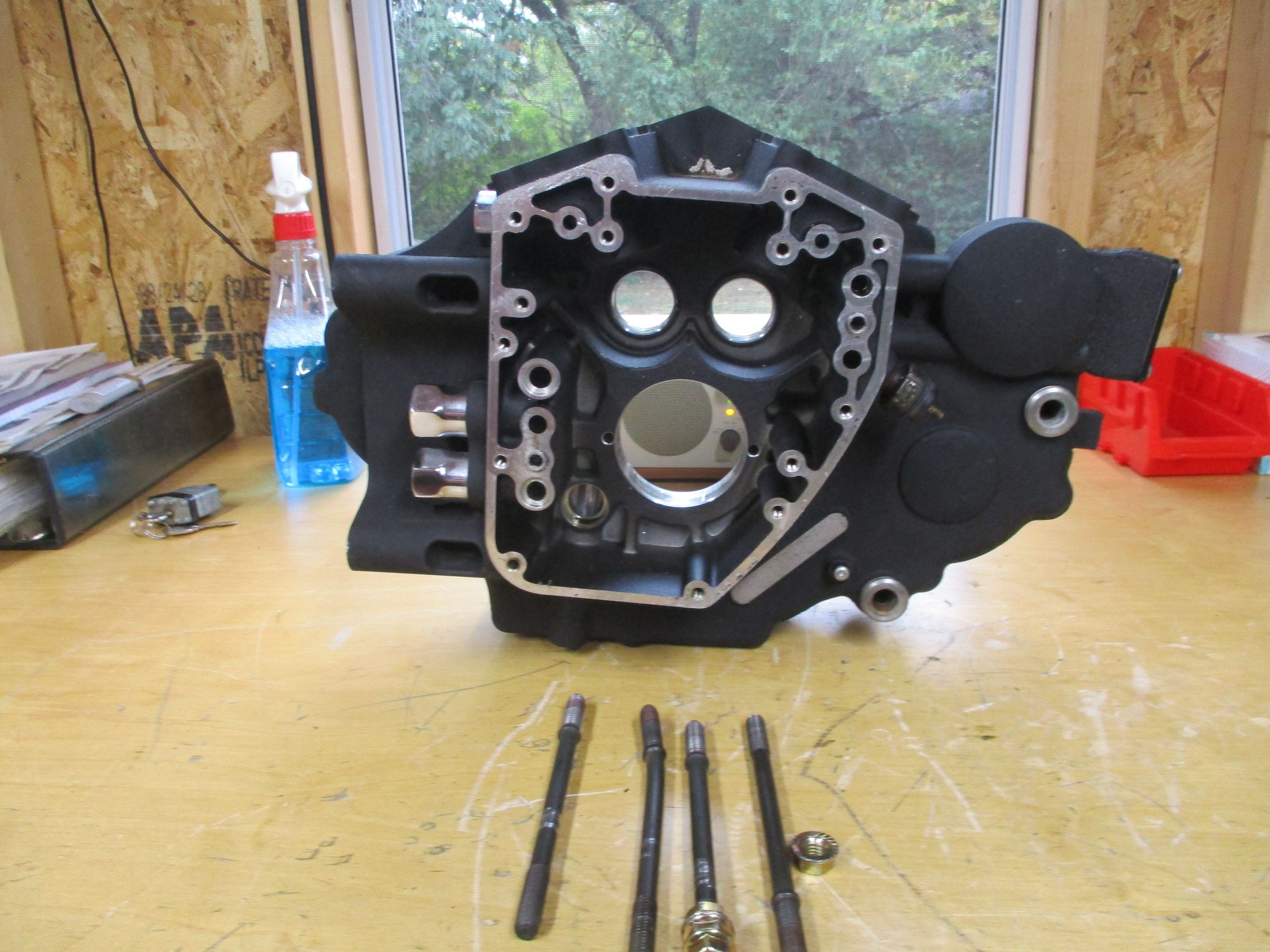

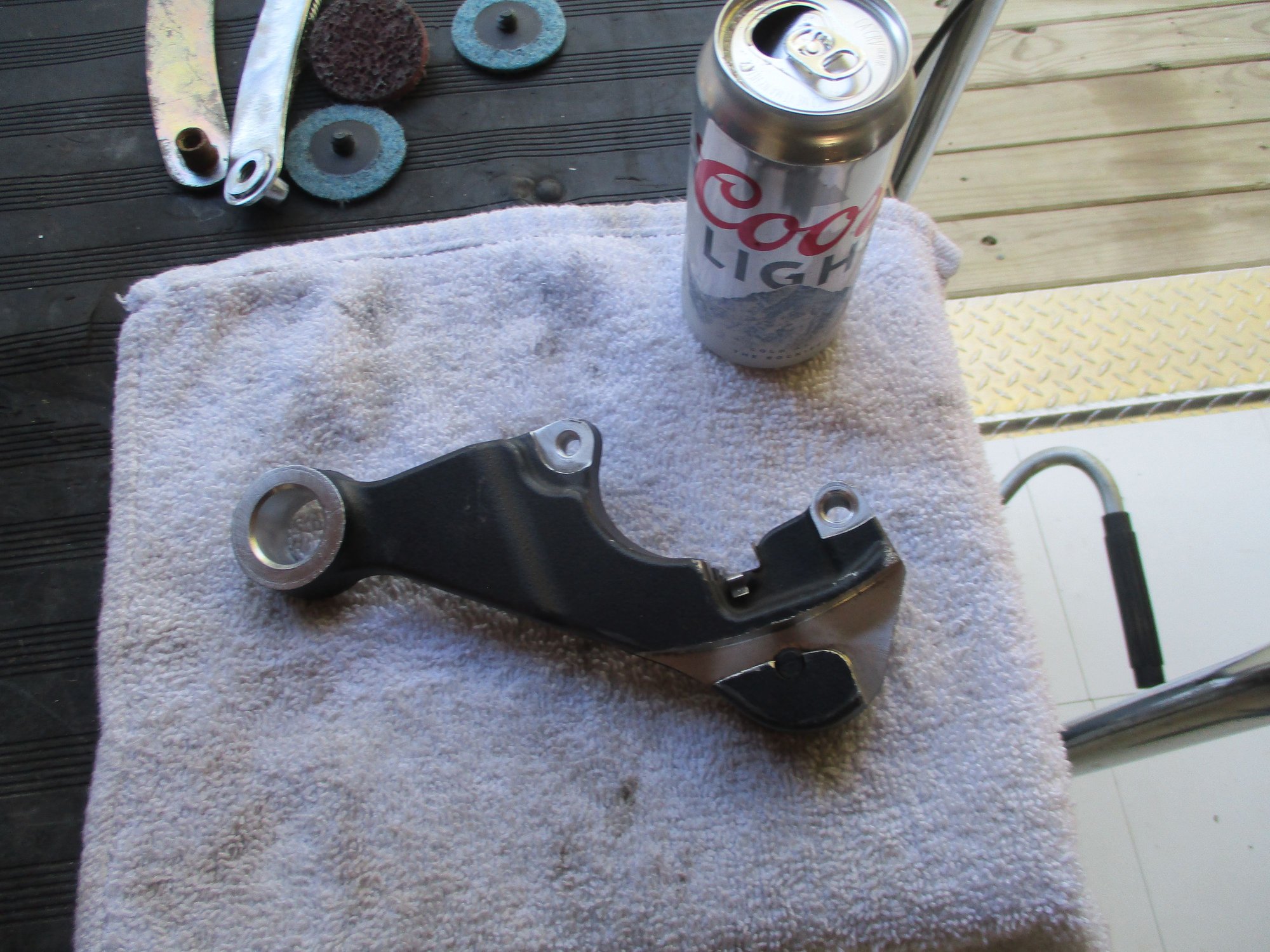

Did some cleaning today. Threads chased and rust removed.
