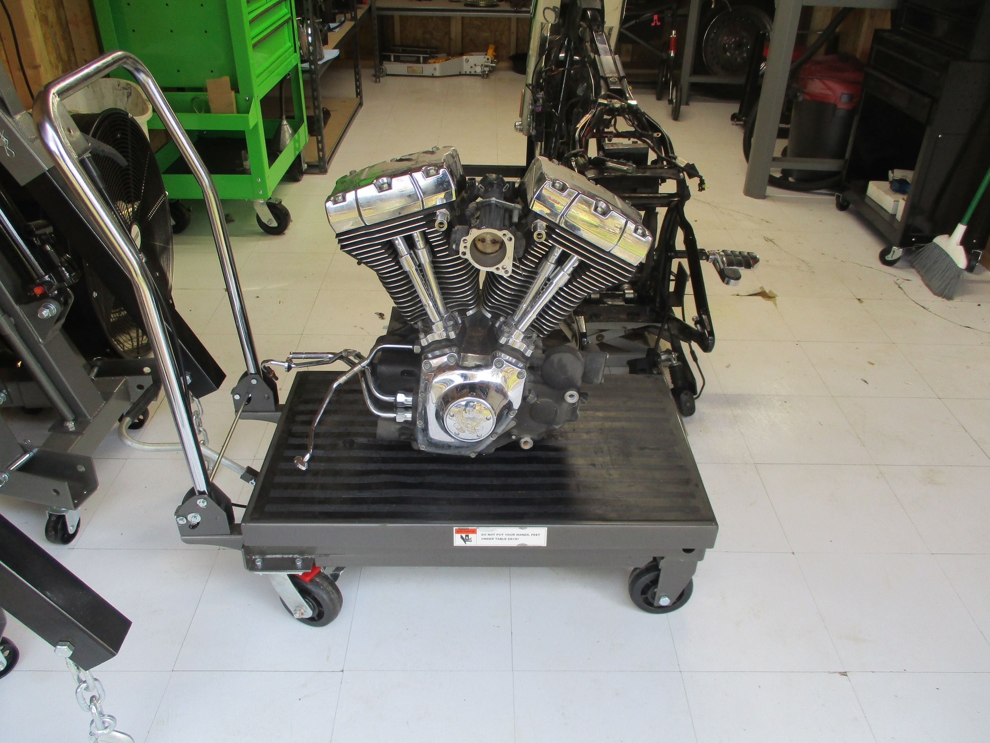

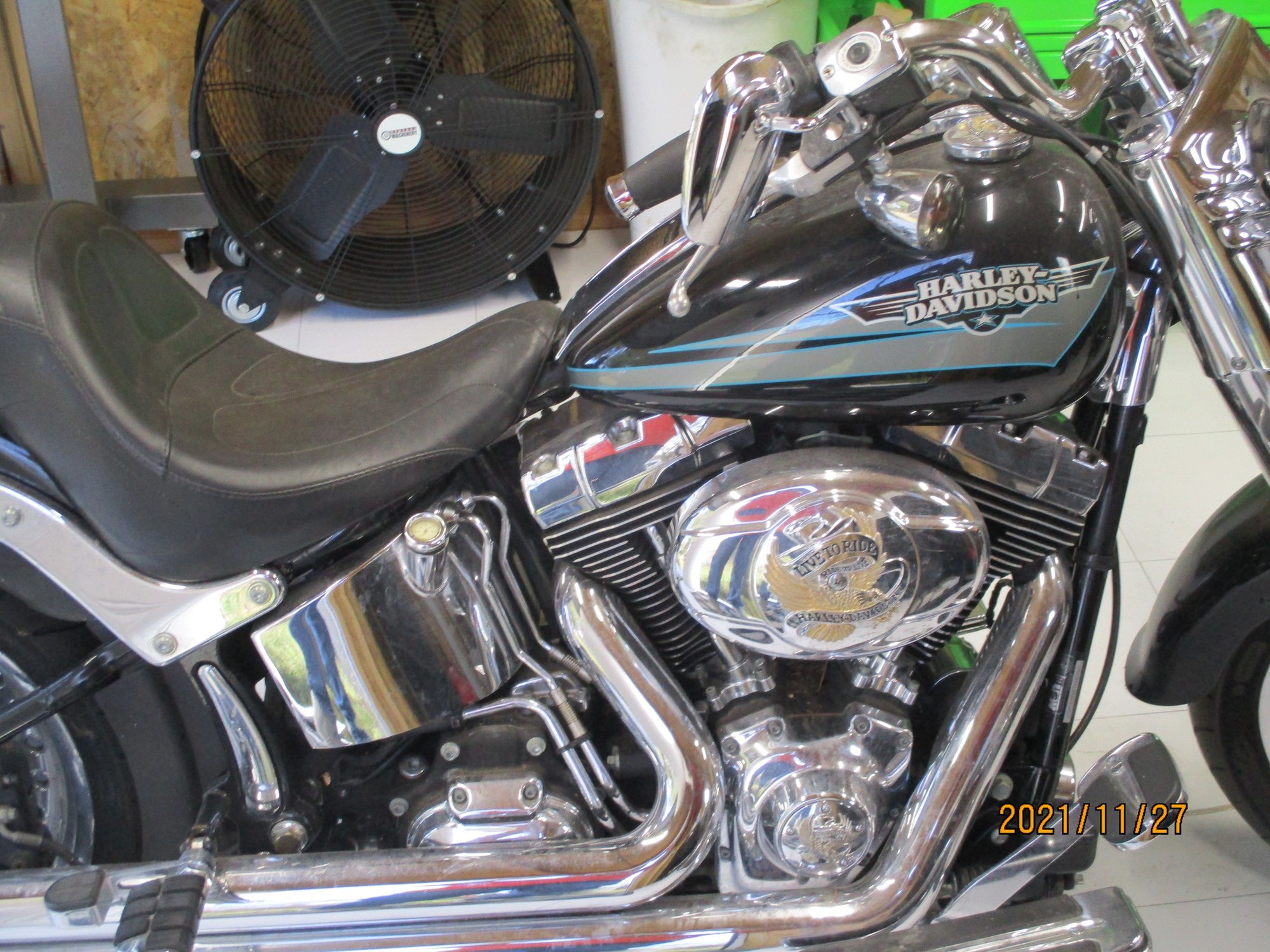

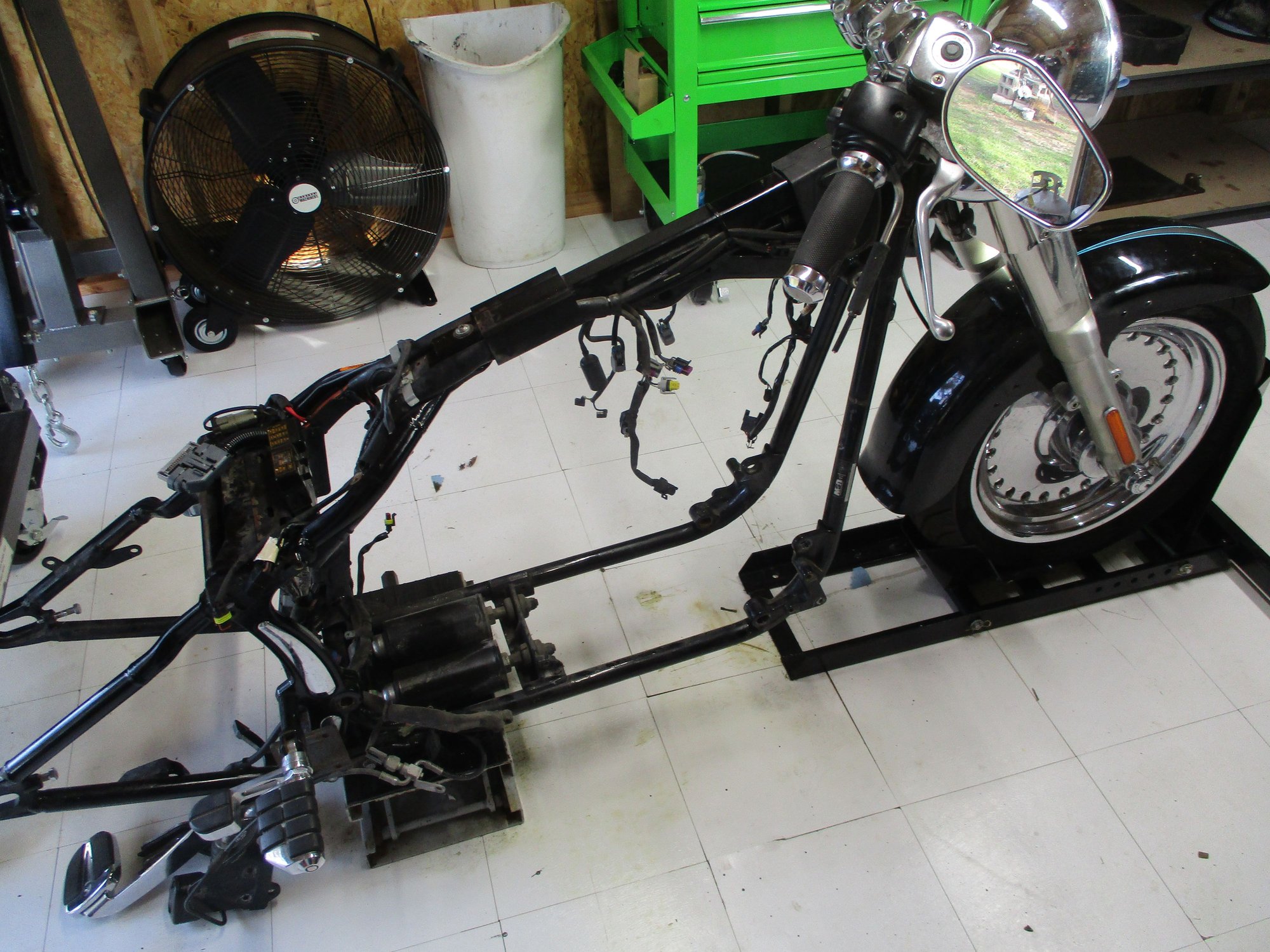

Bought A Rocket X back in 2015 and the 2010 Fatboy sat on the front porch. Transmission bearing was going south and never got around to fixing it. Now we are in the process of rebuilding it.
Engine will be first. Going in with a S&S 110 Kit. Plus A S&S crankshaft. New injectors and throttle body.

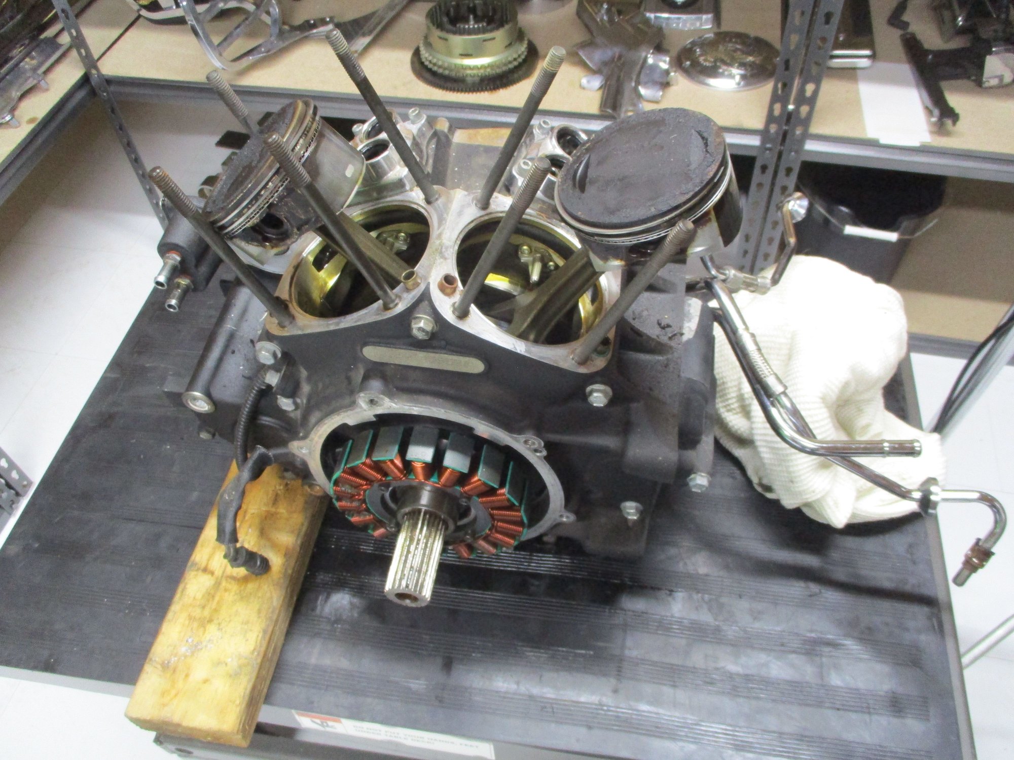

Looking good.

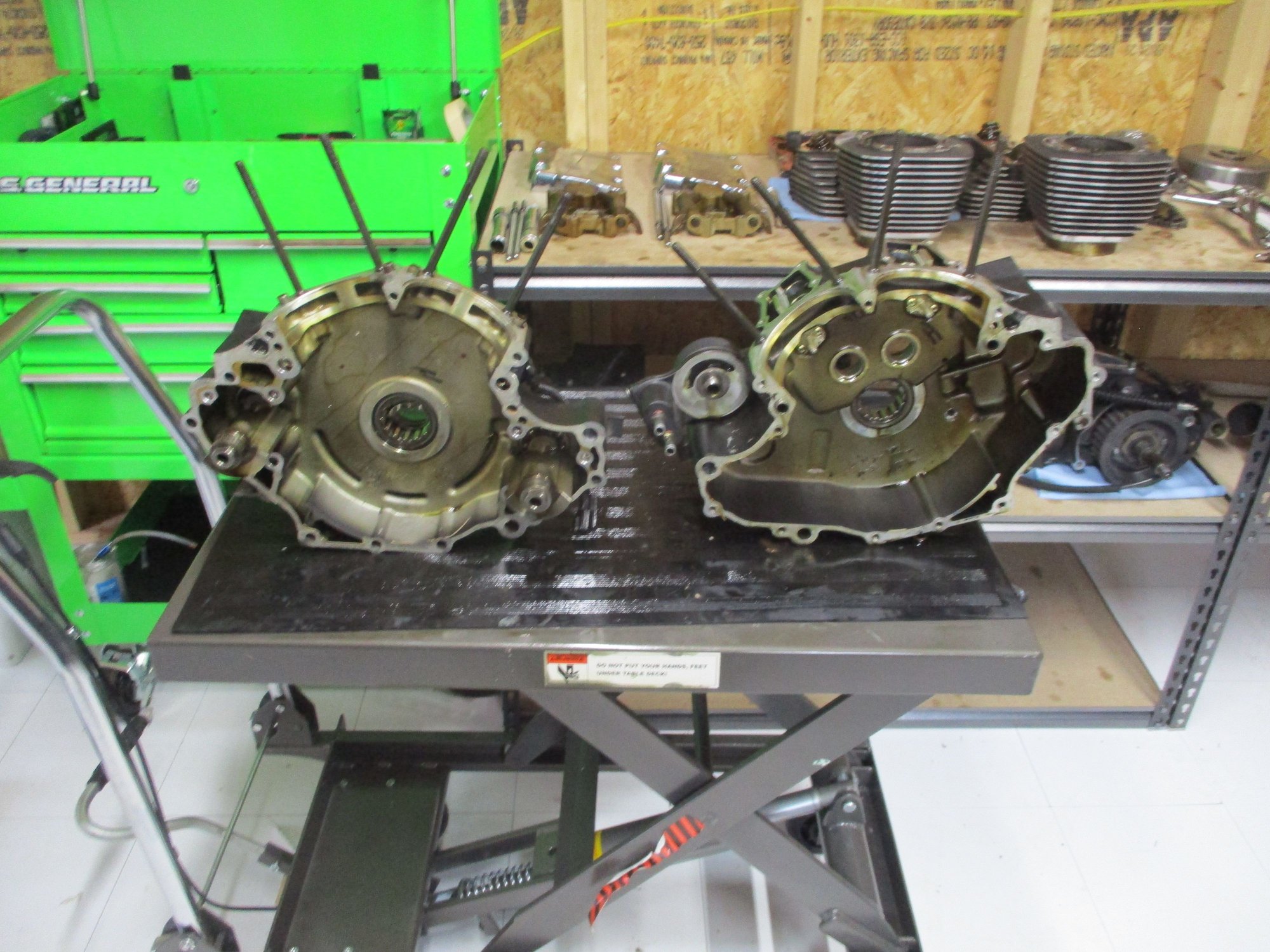

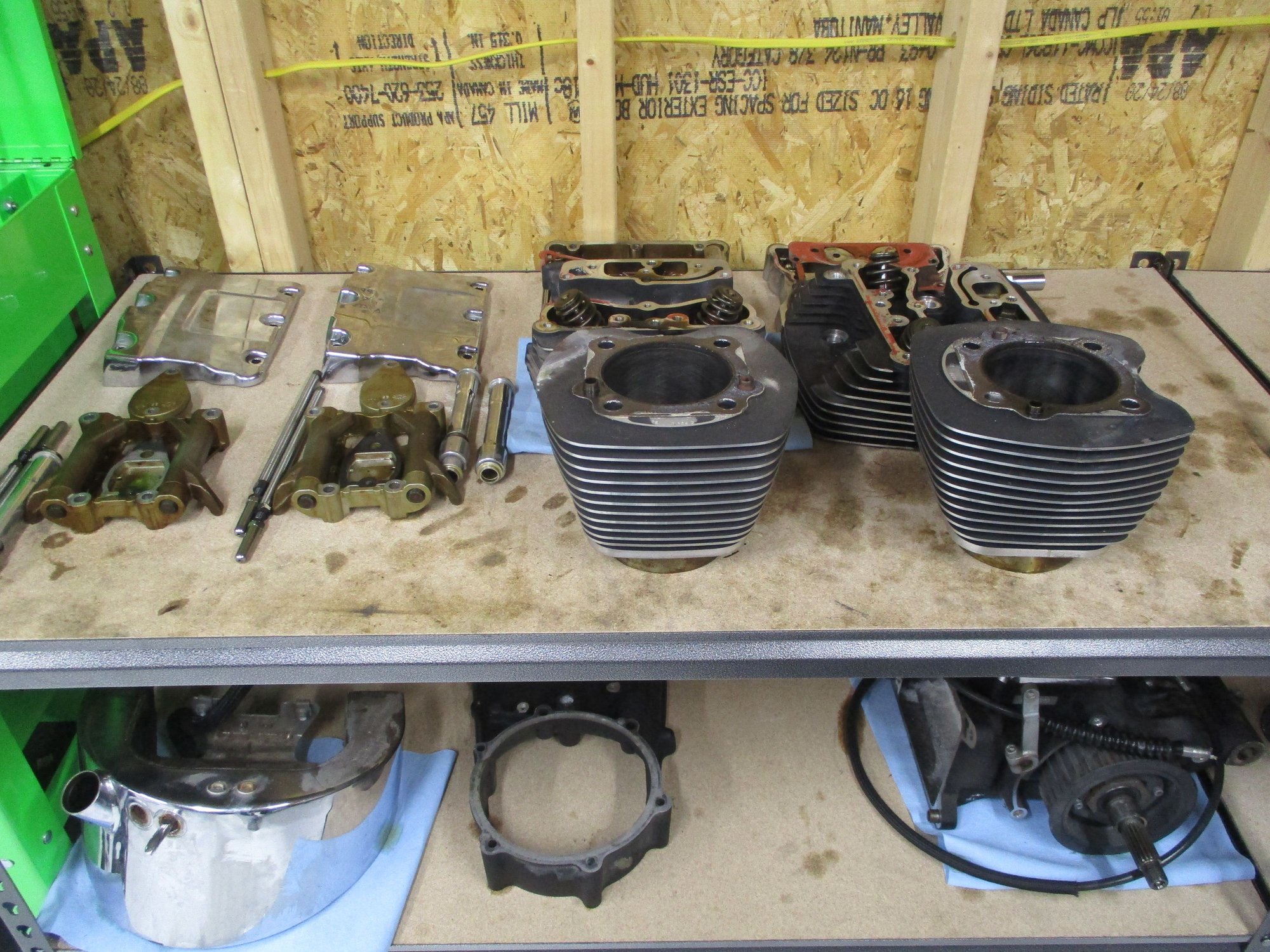

Top end is getting replaced with a S&S 110 kit. More to follow.

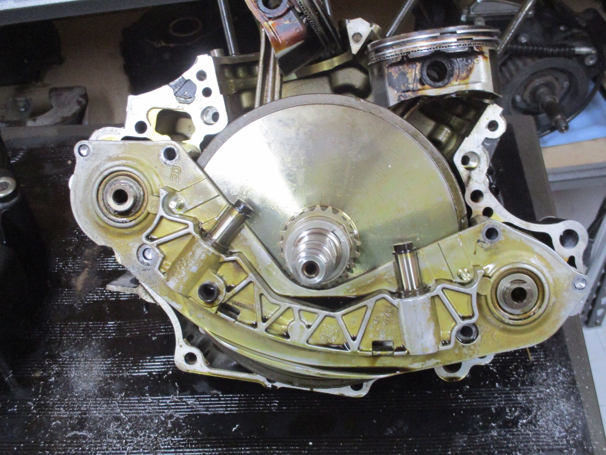

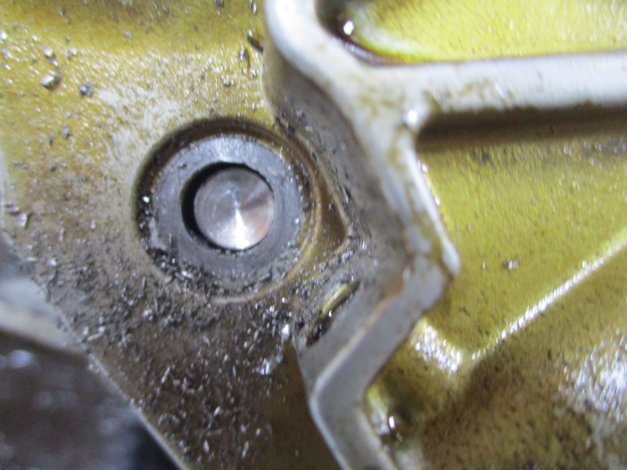

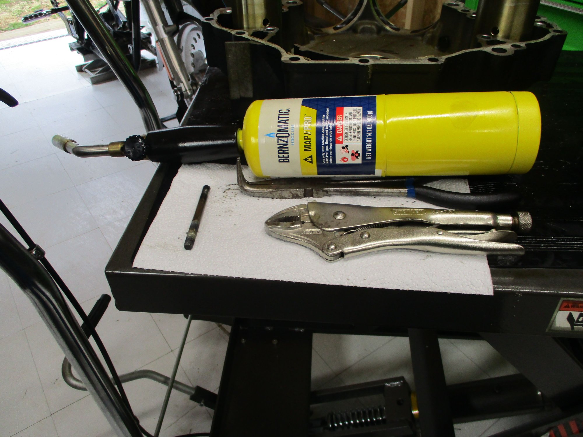

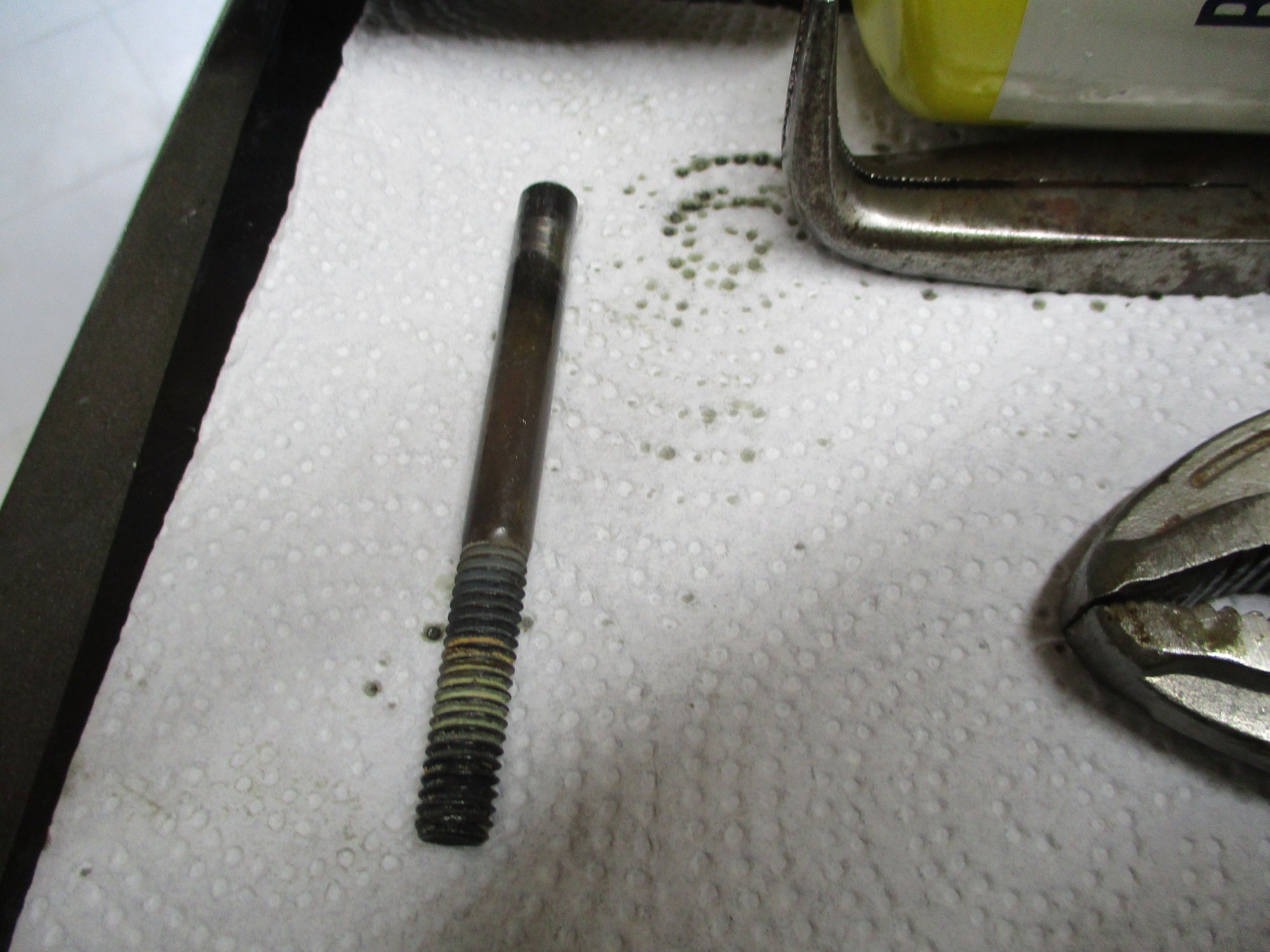

Got at it. Removing the counter balance assembly was a joke. The six T40 torx screws were heavily set in red Loctite. Why I have no clue. Factory job. Took some work to get her apart. Three bolts came out easy. The other three took a lot of work. Drilled the heads off and removed the counter balance. Then heated bolts and removed. Following pics explains it all. Believe Harley did all the above either to screw with the home mechanic or to make it next to impossible to remove with out screwing up bottom cases. Well MR Harley guess again.

Really kind of pissed me off. Never seen such a joke of assembly. Took my time and figured out a good approach to get the job done and save the cases. Direct heat on the torx screws or bolts could have caused some major distortion on cases. Here is a clip from the manual to back up my idea that Harley is out to screw the home mechanic. Complete JOKE. Never mind this is the step before removing t40 torx screws. It is all the same.
