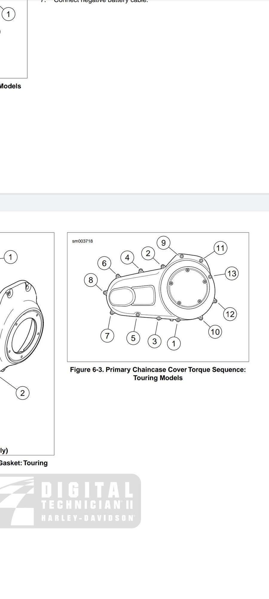

2007 Heritage Softail with a leaking primary cover. Would like to re-torque the screws but don’t know the torque value. Any help would be appreciated.

I agree there is no reason to torque them, because they are not a critical fastener.... but if you want to know, most years are 84-120 INCH pounds...
I do use my torque wrench, but at the middle of the range. I set my torque wrench to 100 inch pounds. I then tighten/snug them by hand, and then torque them, both in the proper order. 100 inch pounds isn't really much more than snugged up by hand....

like the other guys said just snug them up. I think...thats dangerous...the sequence is more important than torqing to max number...

Thank you! Never thought about a sequence. Good stuff. Thanks again.
