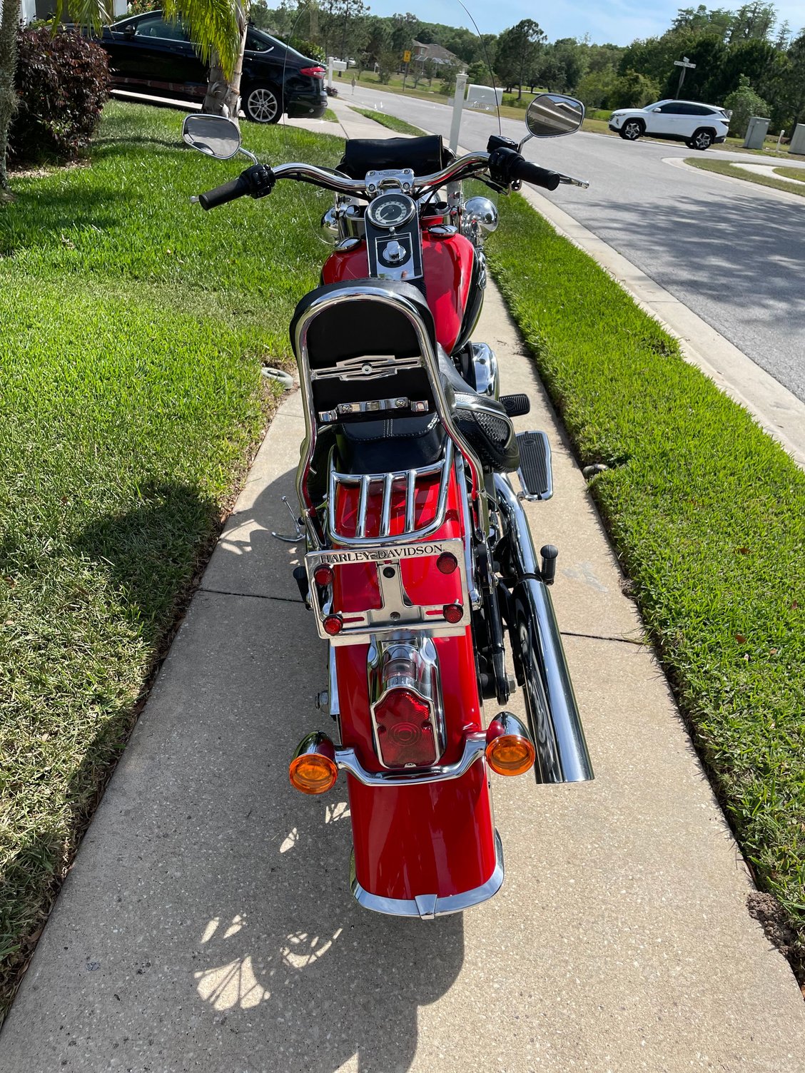

Well, I’m finally back, and the Softail Deluxe is done. Didn’t put a big rush on it, and was overseeing another bike too.
Front brake issue ended up getting a Master Cylinder rebuild. All fluids changed, complete 10k mile check done, belt checked, brakes checked (at about 50%), and acquired and mounted up floorboards, shifters, and brake lever. It came with a new battery and a tender mounted, so that was good. I cleaned it up some today and mounted a backrest pad I picked up. Dressed the leather seats and tank strap, and took pics to get it listed. Came it right about budget and it will make someone a nice machine.
