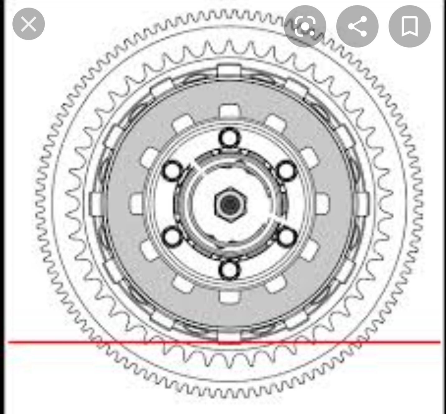

Thanks for the input. In an earlier post, vtbigdog references a video that shows to fill to the bottom of the clutch plate. Brakeless posted an image from a HD manual showing the same thing. I think I'll not try to use a specific # ozs. I'll simply fill to the bottom of the clutch plate, which should always be the right amount.

Forget about how many ounces it takes, just make sure the level is correct.
Go back and look at the picture that brakeless posted.
This is very simple stuff...Don`t make it complicated.
This is the correct level for primary lube on all Big Twin wet clutches (which means mid `84 and later).

Just checked primary oil level vs bottom of clutch plate. It was overfilled by 4ozs. Will drive/test bike when not raining, which is likely tomorrow. If my oil level adjustment doesn't fix the neutral problem, clutch adjustment will be next. Thanks again for all the advice, video and diagram!
