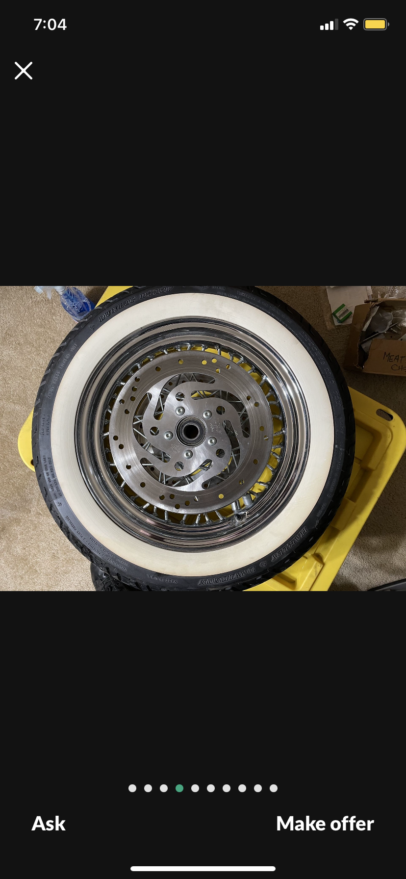

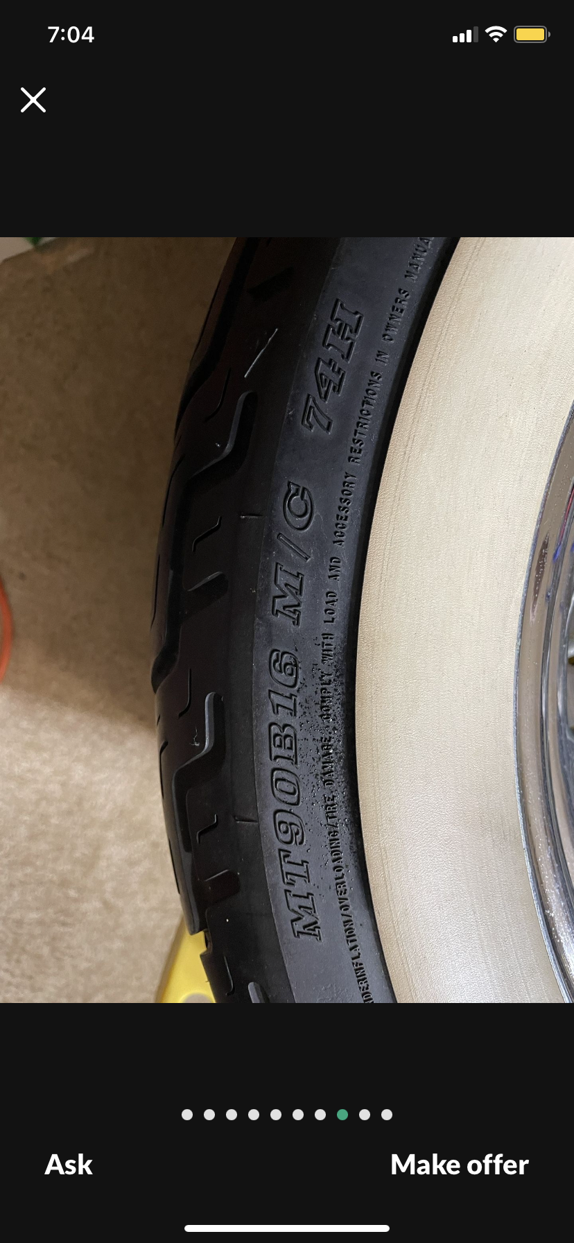

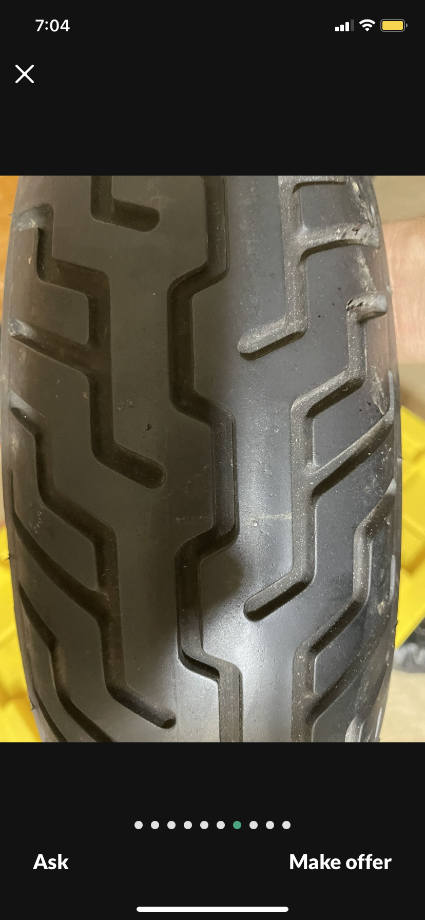

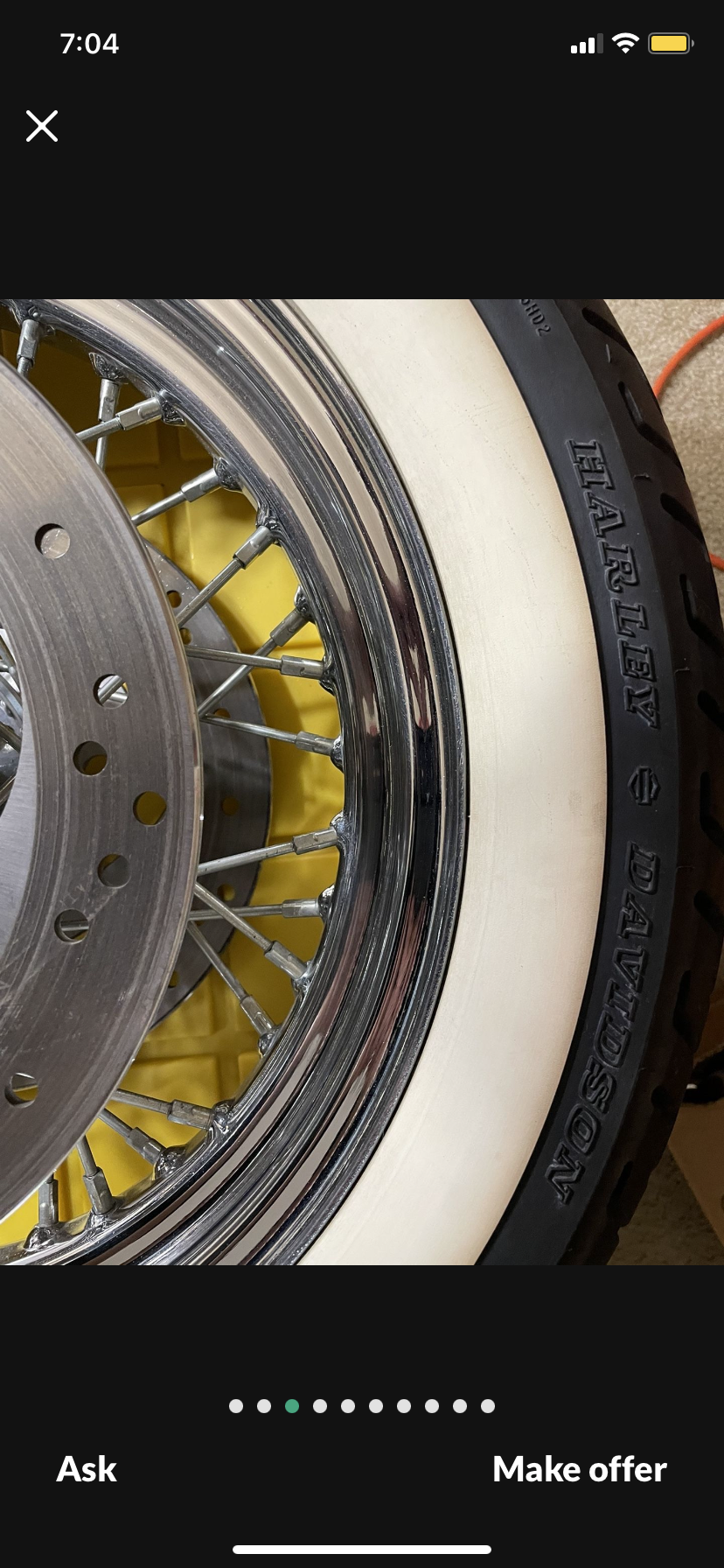

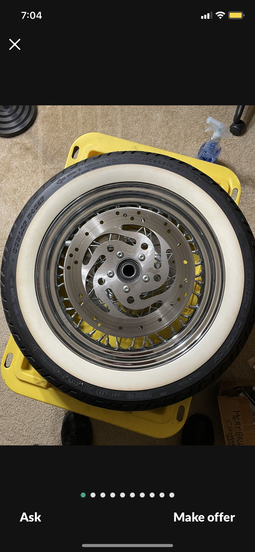

Have a 2000 Fatboy FLSTF and am looking to swap out the stock thick rims with some spokes and white walls. Found some online that says it’s from an 02-07 bagger with the same tires i’m running now, just not sure if the rims will fit on my fatboy. Anyway to look that up? I have attached pictures for reference. Appreciate any help!
Harley Davidson Dunlop d402 &402f white wall
Front MT90B16 M/C 72H
Rear MT90B16 M/C 74H

I'm not experienced or knowledgeable about wheel swaps between models and years, so I won't share my unqualified opinion about fitment.....
But I will share an opinion on those tires:
IMHO.... if you are planning on using the tires on those wheels, I wouldn't consider buying them without first seeing a picture of the tire date codes. The one side wall pic suggests to me they could be an older tire... In one of the pics, you can see the tire date code on the sidewall, but when I tried to zoom in and read it, it was unreadable..
FYI.... Some switch out their tires at 5 years, I (along with other people) change them out at 7 years, a few will go 10 years... but no tire manufacturer recommends running a tire over 10 years old, regardless of tread depth...
You only have two tires between you and the pavement on a bike.... I pay close attention to my bike tires age & condition...
You could go onto a an online parts finder if you want to compare wheel part numbers used between years and models... that should give you a clue as to what will fit and won't...
http://partsfinder.onlinemicrofiche.....asp?make=hdmc
