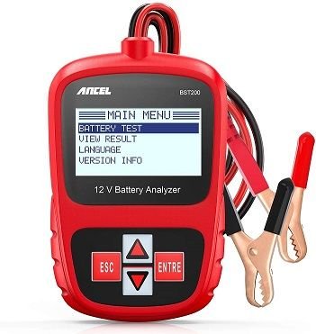

A multi-meter is a good tool to have for diagnosing voltage and resistant/continuity issues. However they are not that useful in checking Cold Cranking Amps on a battery. If you have a lot of vehicles around it is useful to have a digital battery load tester so you do not have to run to a parts store to get your battery tested.
I have this one and it works just fine.

CoolBreeze, That's a great unit! Especially for only $42. Just might order one myself.
