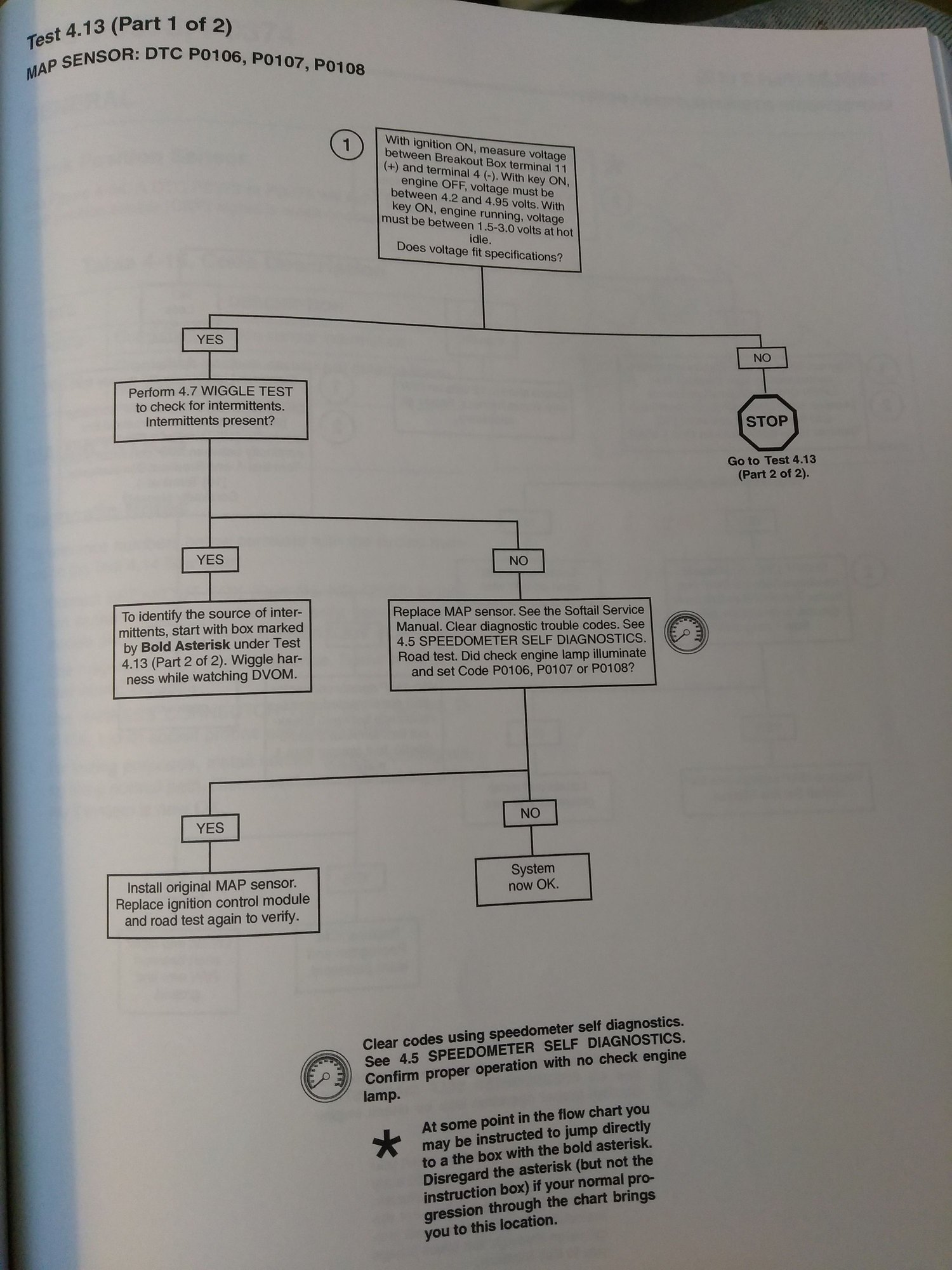

Has Throttle body been off to cause a vacuum leak. Wiggle test wiring.
Sorry about order. On a phone, limited wifi, with numerous memory errors. Note order is backwards and the schematic is a flyer.

Got new intake seals when I picked up the new map sensor, just changed the sensor and checked for leaking seal when I started it( sprayed around intake seal area with starting fluid, no change in idle), did the wire wiggle when it wouldn’t go before I called the rollback, didn’t do anything, the pictures you sent gives me a great starting point, looks like it’s time to get out the electrical tester🙄
