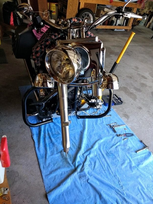

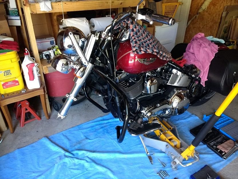

Don't know if you've done the work yet but support the front end of the bike under the frame with the tubes fully extended. I had a friend ask to use my shop to "change the front fork oil". He said he knew what he was doing so I went in the house. A while later I heard a big crash, you guessed it, he took the fork caps off without the supporting the frame and the springs and a large amount of oil came shooting out when the forks collapsed and the front end dropped. Must have been a bear to turn the fork caps out with all that pressure on them but he managed.... Good luck on your project.

Did mine with the bike sitting on a jack. 2005 Deluxe.
