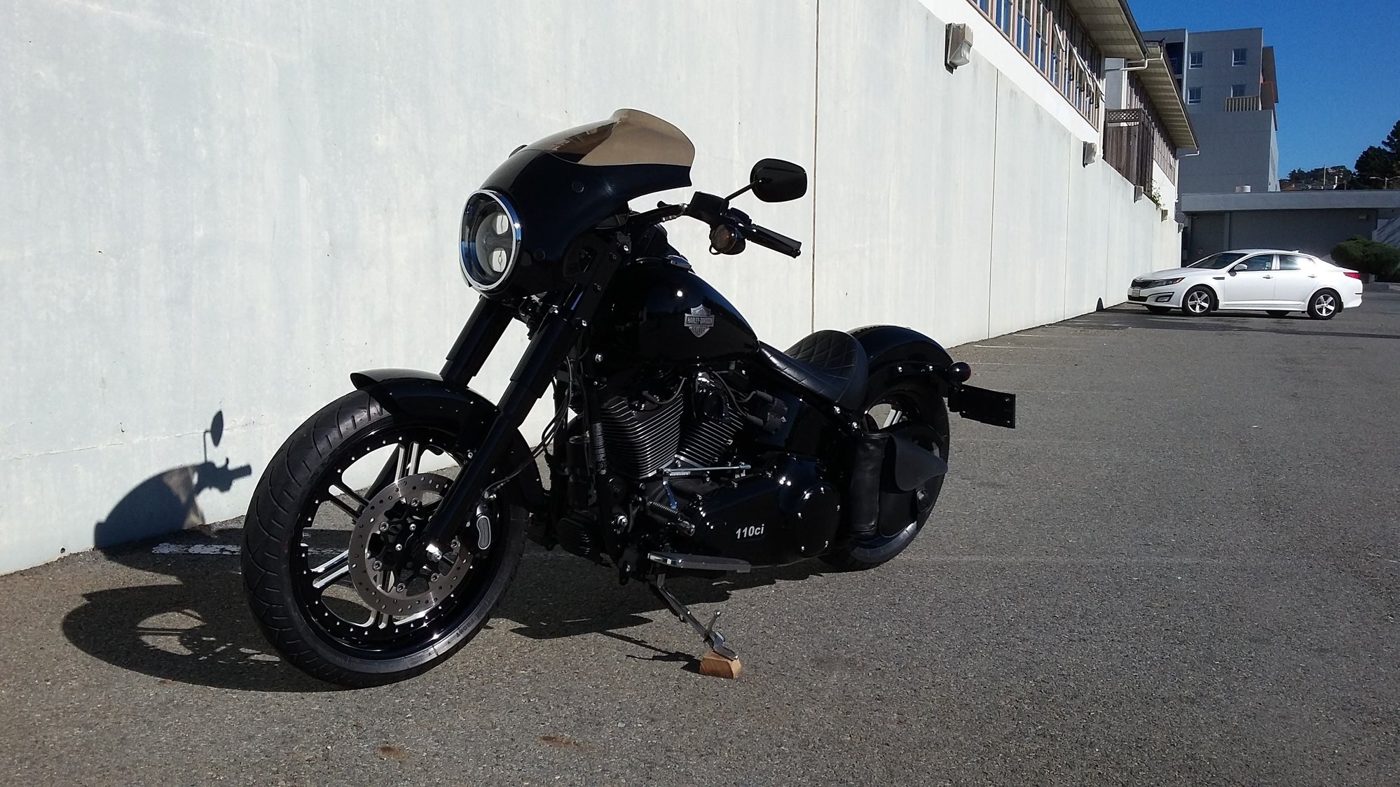

Yes you can easily fit the 18s. I had 19s on my Slim S. No longer own this bike. 18 at the back btw.
that looks awesome. What were those wheels, if you recall?

Thanks! They are Indy Black Magics sold by Hogpro.com

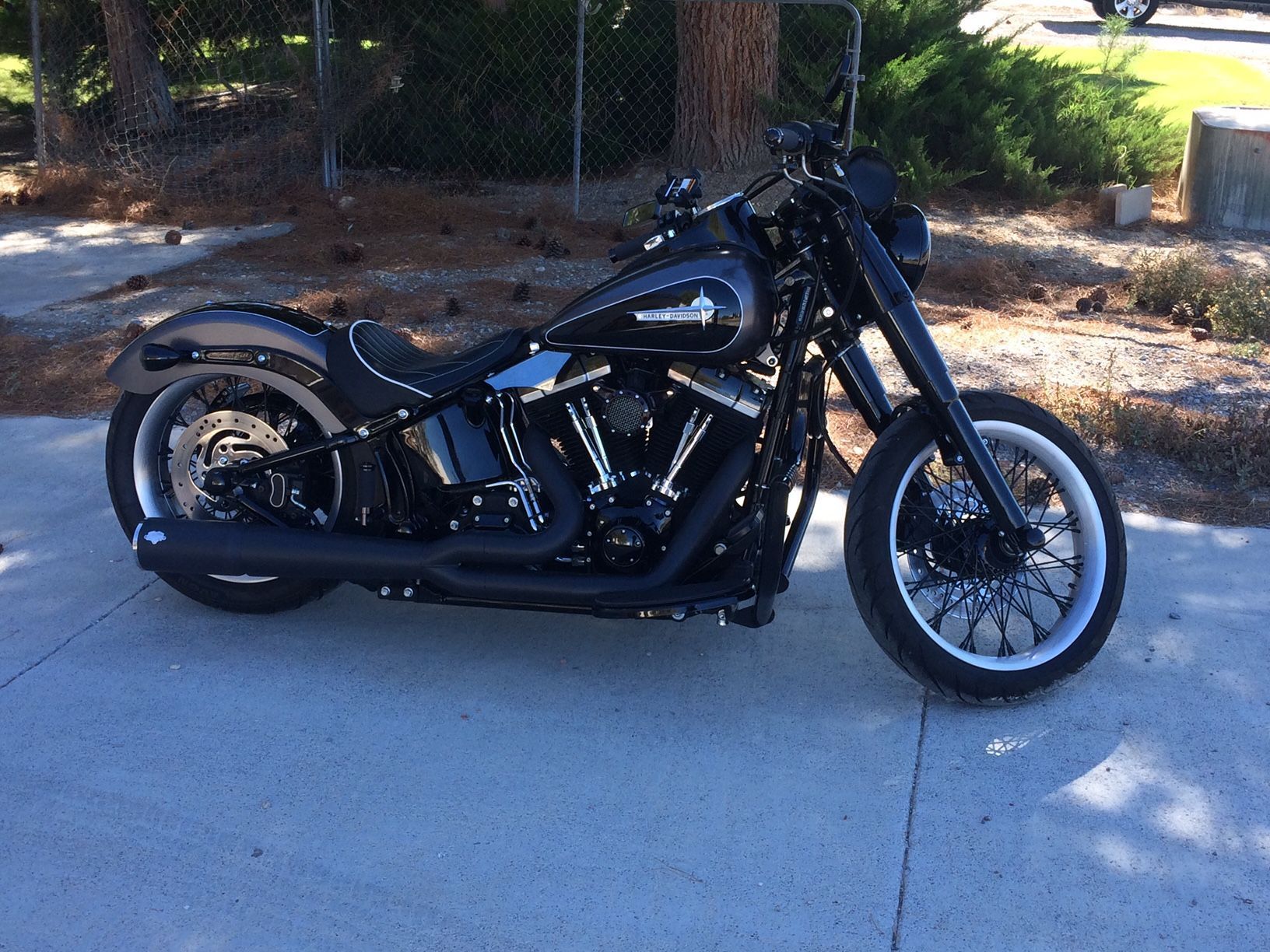

Just wondering, did you want 'mags' or wire spoke wheels ?
If you like the spoke wheel looks, HDWheels has quite a few
different wheels. Just depends on how you want them to look...
Here's a pic for example (not my bike);
