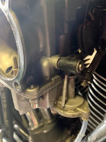

Unreal. Im prepping all my new parts and start to pull the carb. How on earth did my bike run with the accelerator plunger pin completely pulled out??
How can this happen? I noticed no gas spraying from the carb just as I pulled things. I roughly reassembled the pin linkage and noticed that the travel on the pin up and down is only for the first 1/8th or so of handle throttle. after that things bottom out and I think the linkage spring just gets super compressed(?)
and the rest of the throttle is pointless to the plunger stroke.
anyone see this before?? wth. are there linkage rebuild kits? the plastic piece is all wore where the spring got into it. and there was a tiny piston ring and cotter pin that are damaged. geeez

I just solved my own mess....I had pulled the bottom of the carb last year to check the float.
Don't know how it happened, but obviously someone took it apart and reassembled it wrong...
FWIW....
1988 was first year for the CV40 carb. It did not have an accelerator pump... The 1988 CV40 had a richer needle, to make up for having no pump.
In 1989 the CV40 got the accelerator pump. Then, the 1988 needle was used in the later CV40 carbs to improve the midrange mixture...
The accelerator pump version runs much better, but even without an accelerator pump, it could still ran reasonably well if well tuned. Since yours was tuned with the accelerator pump, you were probably running lean in the midrange, and a little sluggish on acceleration. Based on the original tune and/or mods, you may not have noticed...
