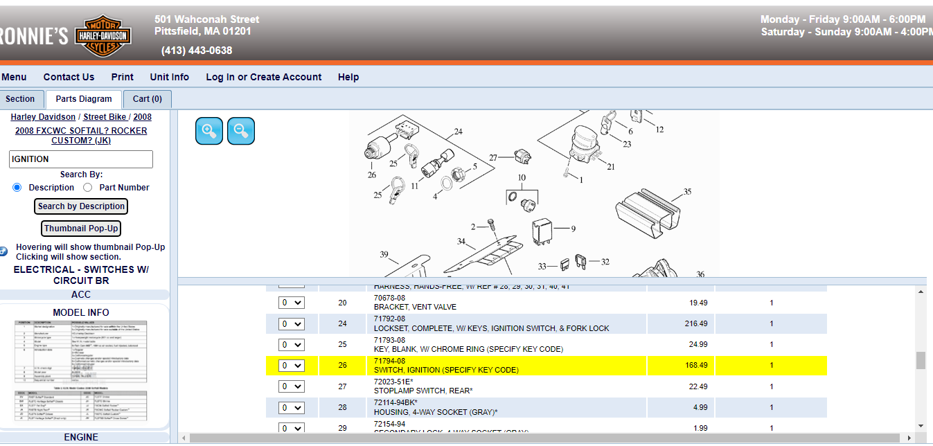

According to Ronnies that's a "71794-08", seeing that from Manchester Harley, https://estore.manchester-harley-dav...ey-p99213.html

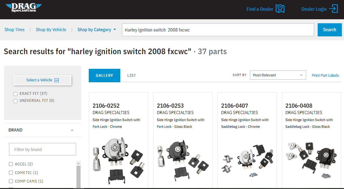

Is this it?
Might try Drag Specialties
