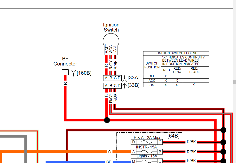

Probably a stupid question but I'm going to ask anyway. Is it possible for me to just do away with the key and direct wire it with a toggle switch?

Sure but anyone who knows where the switch is could take it and go for a ride
All the switch does is connect R to R/GY and R/BK for ignition or just R to R/G for Accessory
