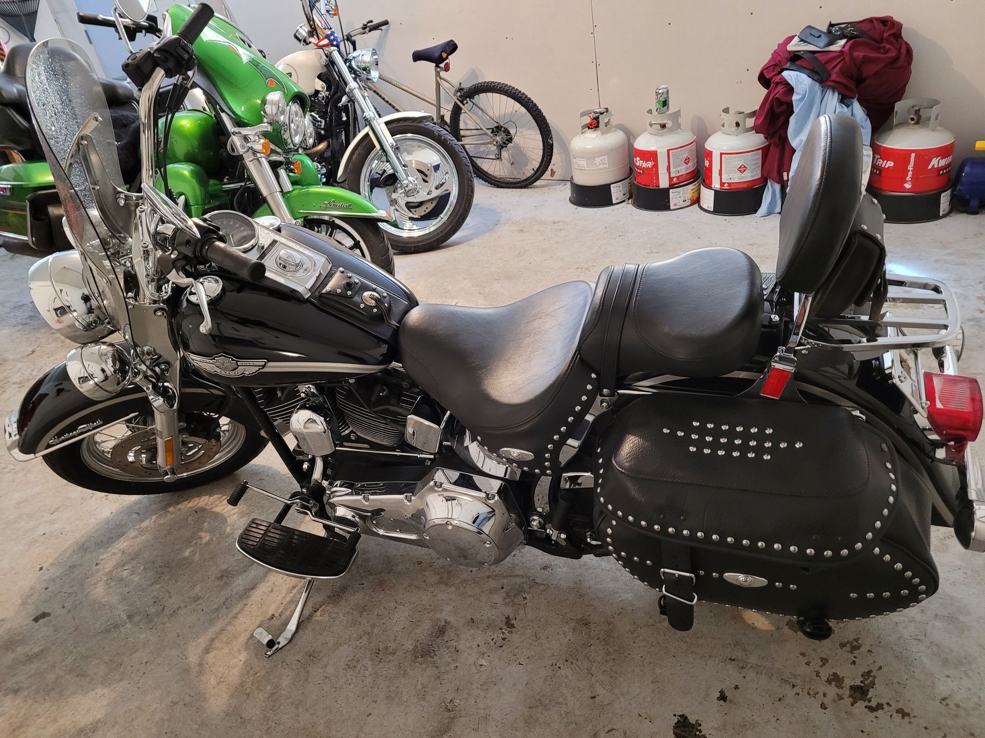

Thanks guys I will play with her some today, had to break her in the right way and ride home in the rain.
The original owner said that would be the first time it ever saw rain. With only 10k miles I believe him.

Wow.... other than the rack aft the sissy bar, the pouch aft the sissy bar. and the pouch on the tank console... that looks all OEM..... Nice find..!!!
PS- it may have frenched trim rings on the headlight/spot lamps...
Good eye, he changed the trim rings, windshield and added the other extra items you mentioned. he saved and gave me the original parts. I put a new battery in it and got to find some slip-on pipes for it. Oh, and tires definitely needs tires. look brand new but probably 10 years old.
