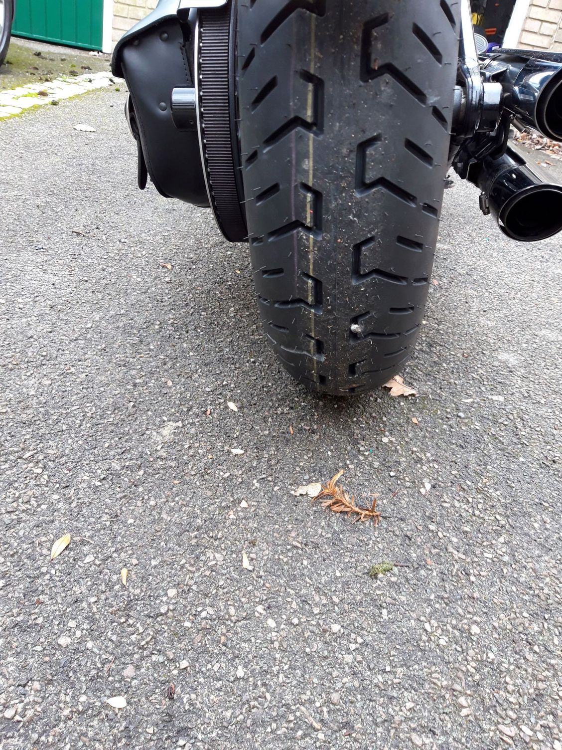

Basically the same year Heritage comes standard with the wider tire Dunlop D401 150/80B16, not exactly the same fender but the spacing of the Belt, Wheels, etc. are all identical to the Deluxe.
I have a '16 model year Slim which is the same suspension and set up of the Deluxe and have installed a Continental ContiTour 150/80/16 instead of the Dunlop MU85 to fill the back end out and have plenty of clearance and no issues.
ContiTour 150/80/16
