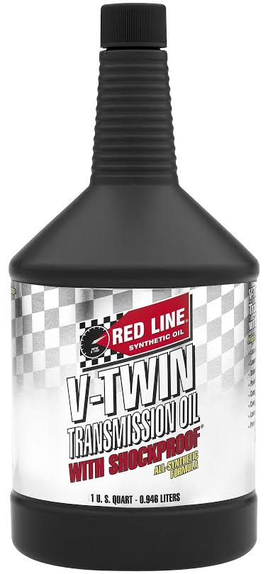

Adjust the clutch. This is the issue in many cases of not being able to find neutral.
Check oil level is correct and not low in the transmission, or too high in the primary.

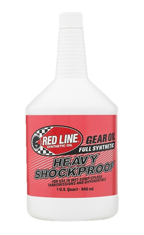

For fear of igniting an oil debate may I just say that Redline V-Twin with shockproof has always worked very well in my '09 Fatboy after changing from another brand. Very smooth changes, greatly reduces 1st gear clunk, and finding neutral is never an issue.

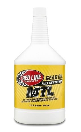

Redline MTL in the Primary.
Redline Shockproof Heavy in the Gearbox
Works for me.
