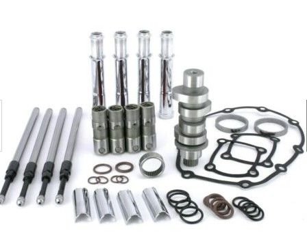

I got a Red Shift 468 sent to the UK as part of a Zippers package with S&S Pushrods, Lifters, Bearings and Gaskets, through e-bay from American Classic Motors.
As others have said do your research first and look as to which cam suites your needs best, there's a lot of information on the Fuel Moto site.
