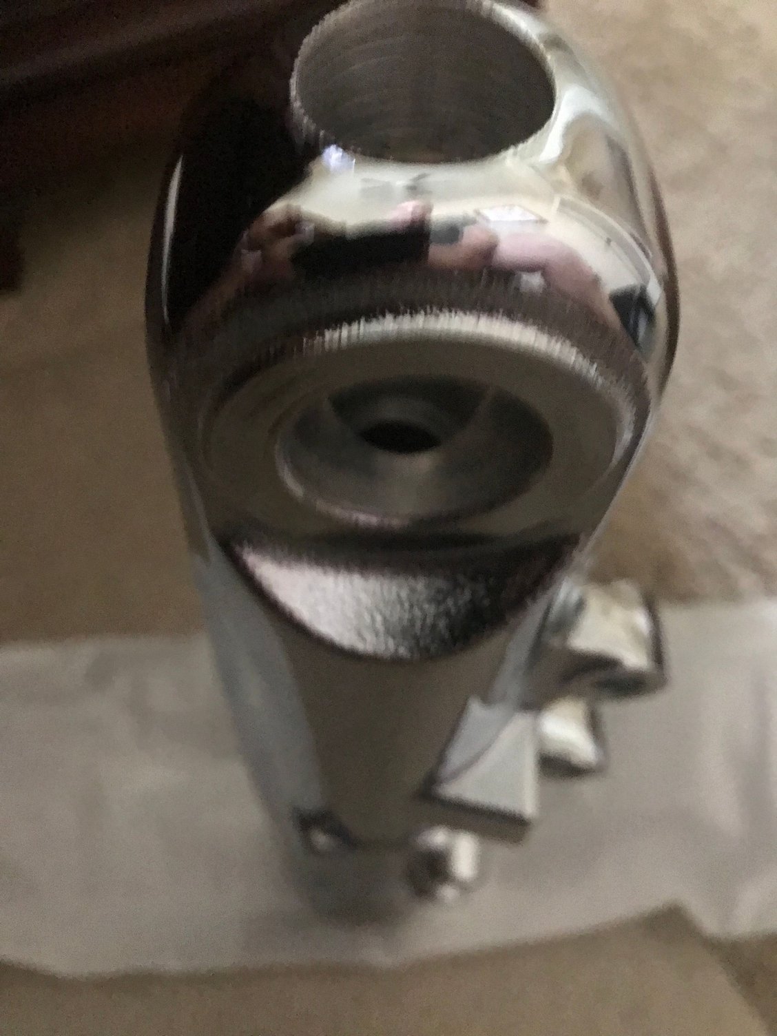

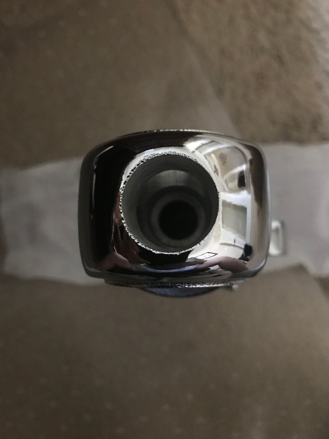

You’ll need to remove front axle to access drain plugs. Have an extended Allen bit ready. Had to use the torque of an impact to get mine off. Don’t need to remove forks.

Originally Posted by Shellfish20
so the drain screw looks like its inside the axle bearing housing according to the diagram, does that sound right?
On one of the forks it’s a solid piece so you’ll need something like tool pictured. See if these pics help. I also put a new copper washers on the two bolts.
