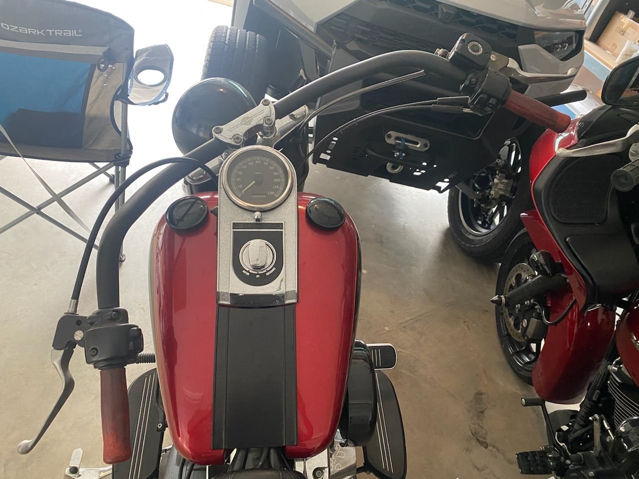

I’m trying to find some touch up paint for this 1999 Fatboy. I’m having trouble finding the name of the red part. Anyone have any good sources or knowledge on what the red is? Thanks

Give the VIN to your HD dealership, they'll tell you and you can order a paint stick.

good idea!!! I’ll call to tomorrow.

There use to be an online chart available from Harley, cannot find it today.
Lazer red? Double check that with HD
Edit:
1999 Harley Paint
Aztec Orange Pearlcoat 61889
Birch White 90303
Cobalt Blue Pearlcoat 191058
Diamond Ice Pedarlcoat 37056
Lazer Red Pearl 75129
Mystique Green 47981
Nugget Yellow 83735
Scarlet Red 72095
Sinister Blue Pearl 190524
Violet Pearl 52111
Vivid Black 9850

These are the colors that were offered for a 1999 Fatboy
Source: Colorite Paint

Also some of your auto parts stores have a gun to shot your bike and match color. I have 2004 Heritage that I had to touch up a boo boo on the front fender and NAPA matched the paint perfect. I think on an older bike this might be better than paint chip because of natural aging. Good Luck!
