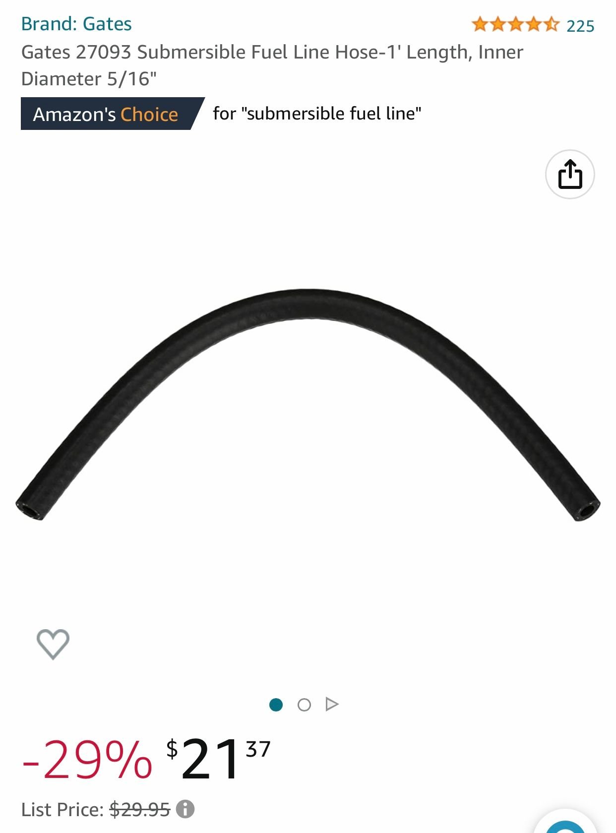

maybe try this out,
Amazon Amazon

That is basically what one of the types I have is. It is not rated for Submersion in fuel. But, I may be trying it anyway. If it just stiffens up, hell that is what the OEM plastic does.
