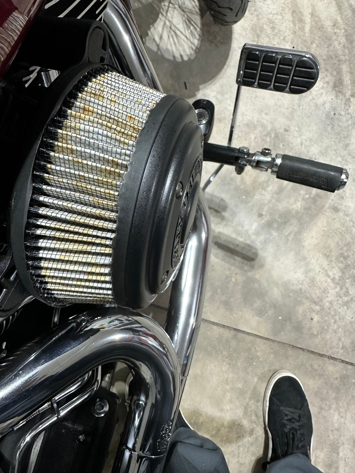

It got wet(and not a lot) and I let it air dry. Not it looks like total garbage. Will this clean up? It’s less than a month old

Relax. Take a deep breath. Yes, it will clean up. Here's a video on how to clean it. The K&N products he is using can be purchased at your Harley dealer.
Is that the Harley SE dry element filter or the SE K&N that requires the element be oiled.....?
I use the SE dry element filters in my bikes. I don't like the gauze, oiled filters by K&N. I have washed my dry element filters several times, let them air-dry in the sun, and never got any rust from the metal mesh bleeding onto the dry element...? I have a one that is 18 years old... it shows no rust from the wire mesh...
If it's the K&N oiled filter, it should clean up and the oil should hide the rust.
If it's the SE dry element filter, I'd try to clean it up.... If it doesn't clean up, maybe take it to dealer and see if they would consider it defective and replace it, but I wouldn't use the K&N oil on a dry element filter just to hide those rust marks....
Good luck with the clean up...

yes it is the dry filter. It’s odd to see that. No idea what caused it. Idk if K and N cleaner is the same as Harley cleaner but as you said it’s a non oil filter

When I clean my dry element filters, I sparingly use "Extreme Simple Green", on any grease, oil, grime spots... It's a special formulation for aircraft so it's not hard on aluminum and other metals like the normal Simple Green...
Yes, it's more expensive than the regular Simple Green. I keep it on hand for my motorcycles, mountain bikes, and cars.. I used to use it in the engine room on my boat too..

I guess my only concern is any of the particles getting into the head.
