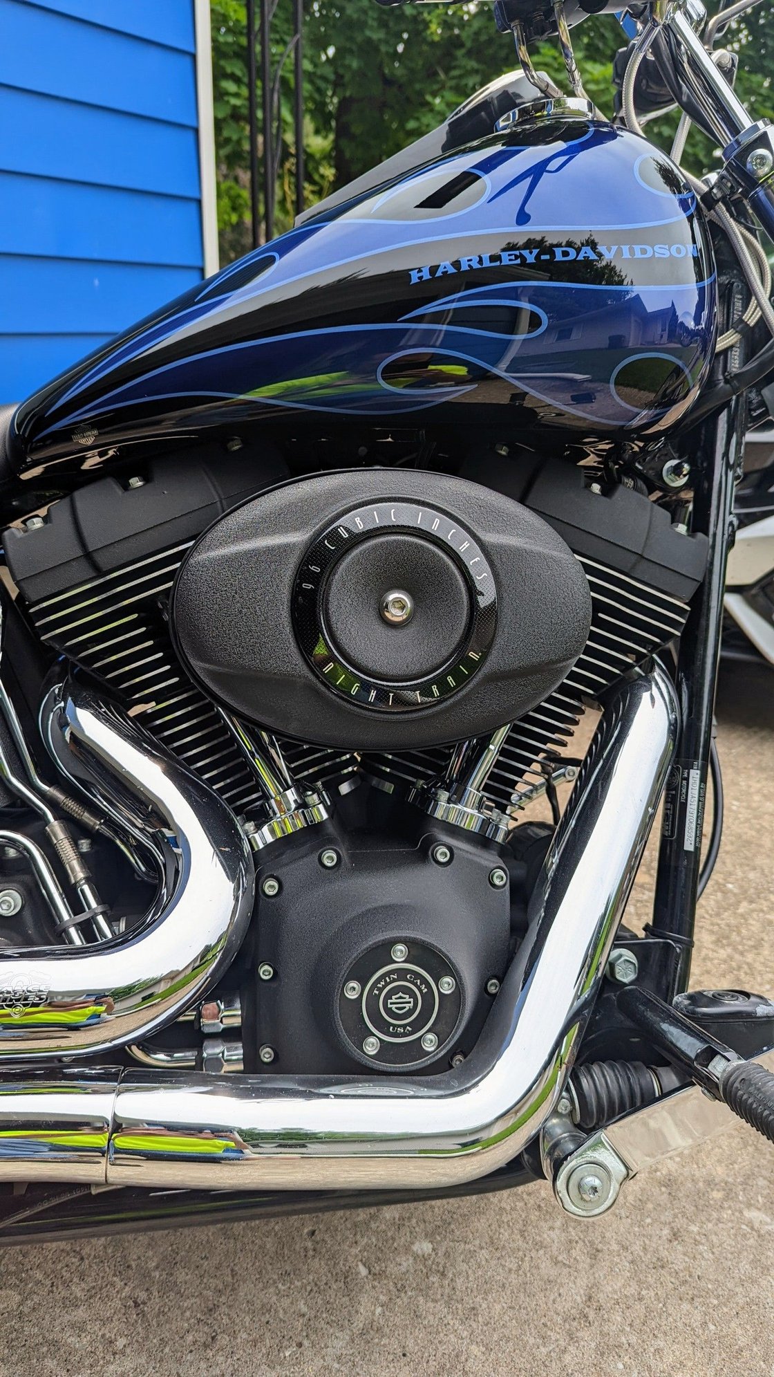

Softail to Softail from '00-'05 should interchange. Not sure about '06 up. An engine/trans from any year Dyna will not work.
Maybe an engine from a Night Train is in your future.

They do look good.
