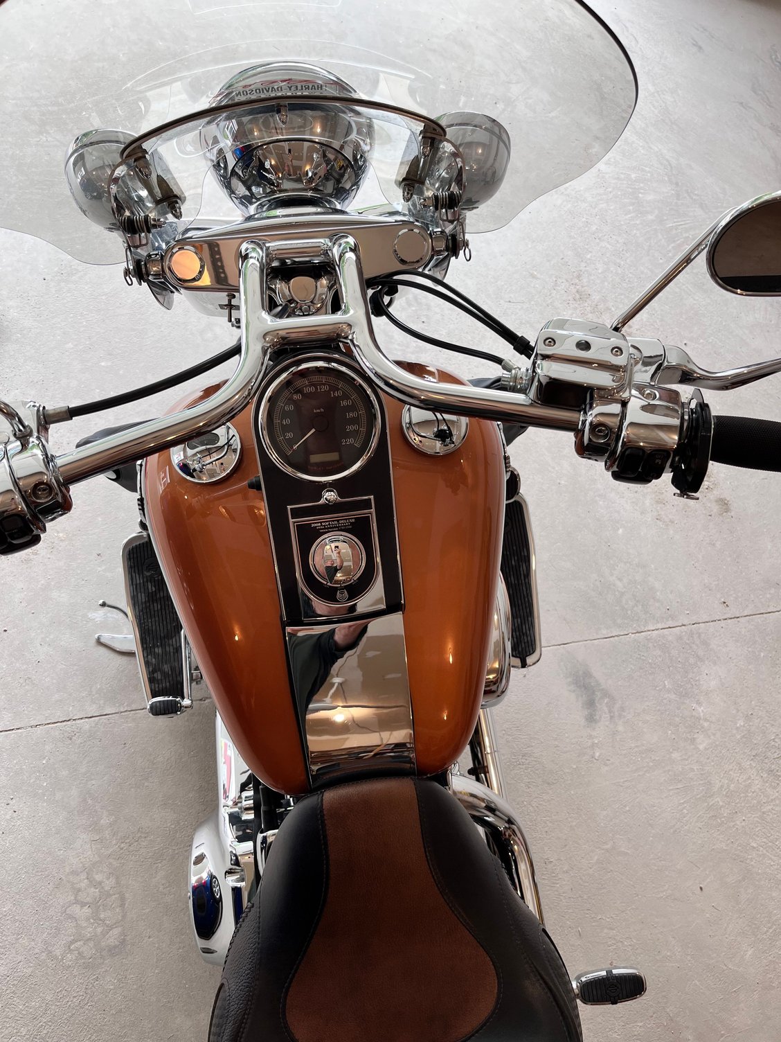

These might work

These might work
What's the make and part number? Thanks!

Pretty sure they are Harley brand, no part number. They were on the bike when I bought it.
