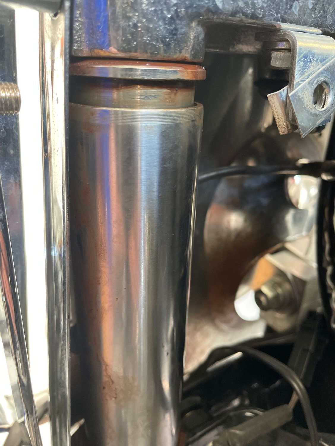

Changing the handle bar bushings on my ‘04 Heritage and found this ! Noticed a bit of oil when I removed the rear covers. The left pinch bolt in the lower tree was broken, allowing the tube to start screwing out of the spring cap. There was only a few threads engaged when I pulled it apart.
Rebuilding both sides now. My bad for overlooking this area under the covers, when checking nuts and bolts. This could have ended badly.

Glad you caught it in time.

Good reminder to check those when performing service.
