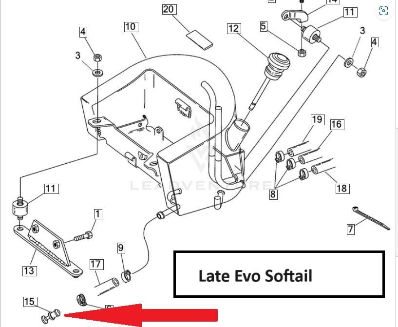

The oil drain hose comes from the bottom of the tank, but not all Evo Softails use the same tank.

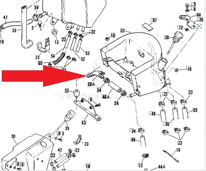

Early Softail oil tanks had 2 nipples on front of tank (oil return and breather) and another nipple on the rear of tank, this nipple was for oil supply to pump and also oil drain (there was a T fitting).
Later Evo Softail tanks have 3 nipples on front of tank, oil return, oil supply and vent, and one nipple on rear (drain hose).

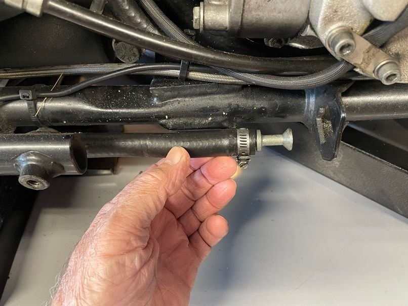

This is what the plug will look like (the hose may not be this long), just loosen the clamp, pull the plug, and glug glug glug...

Here`s the early setup with the T fitting, in `91 the tank changed to the 3 nipple on front, that did away with the need for the T fitting for the drain.

@iviakavelli From your pics I agree, there is no T in the hose coming from the back of the tank.
To drain the tank, disconnect that hose at the oil pump end and the oil will drain from the tank, but remember to start the engine and scavenge the oil back to the tank first.
The company that put the bike together probably used a mis-mash of parts, and the T fitting was probably long obsolete by the time the bike was built.

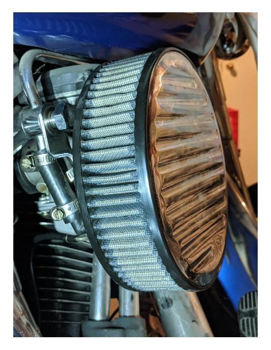

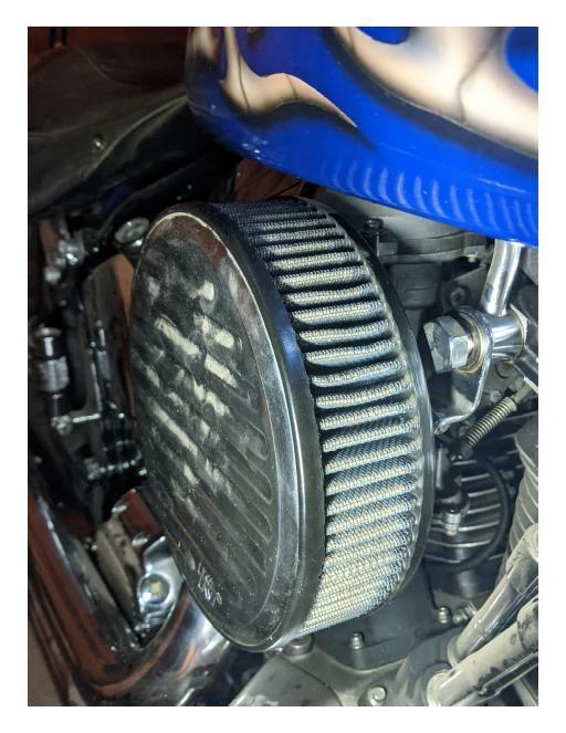

Thanks for the responses, guys. So I think I've figured the gist of things out now... I'm now stuck at removing the air cleaner lol. I'm not sure if I should make a new post or continue asking for help here, so out of laziness I'll go with the latter.
My air cleaner doesn't have a centre bolt (see pictures) like almost all the ones in the Youtube videos do. As you can see, I tried loosening the 2 backplate breather bolts but realized there are still the 3 bolts connecting the air filter to the throttle that I still have to get to... So how do I take this cover off? I'm stumped here..
