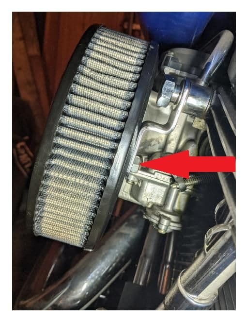

Originally Posted by iviakavelli
That rear hose must've had a T-fitting originally, but the previous owner took it out. It all makes sense now.
There is also the chance that whoever built the bike never installed a T fitting in the line.
My air cleaner doesn't have a centre bolt (see pictures) like almost all the ones in the Youtube videos do. As you can see, I tried loosening the 2 backplate breather bolts but realized there are still the 3 bolts connecting the air filter to the throttle that I still have to get to... So how do I take this cover off? I'm stumped here..
I was unable to zoom in and read what is written on the bottom of that air cleaner cover. Try to google that word/name with "air cleaner cover" and you may find all you need to know about that air cleaner...
Most often, if an air cleaner cover, or some of the center medallions on the newer air cleaner covers, are obstructing the bolt(s), then the cover is usually held on with a friction fit fastener of some type... I have seen that industrial, hard plastic velcro, and other friction fitting fasteners hold that outer chrome cover in place. It's hard to say for sure what type is being used.
On a custom bike, it could be anything from a removable friction fastener to JB Weld....
If I could not find specific info on the internet for that cover, I would gamble it's a friction fit and try to pry it off the air filter to expose the mounting screws underneath......
It's a K&N air cleaner. I will try to pry on that black rubber seal going around it. It might be friction fit, as you say. Thanks.
NOTE: It is NOT a friction fit... DO NOT PRY on the cover...... I found the cover and install instructions on eBay... see the below info..
I found one on Ebay....
https://www.ebay.com/itm/355016664578
If you look at the pic of the back of the package, it says, "Invisible mounting for the outer cover."
I also found the install instructions. It IS NOT a press fit.
Read the instructions and look at the instruction pics (enlarge them if you need to). It looks like the outer cover has two studs with threads that fit through the backing plate and are held on with two nuts at the backing plate. The two nuts should be at 3 o'clock and 9 o'clock on the rear (engine side) of the backing plate.... They may also connect the backing plate to two brackets on the breatehr tubes (figures 3 & 4)
http://aw1.imgix.net/4/k-n/RK-3913_inst.pdf
I hope this helps...

I got it, guys. Thanks again for the help. I saw those two bolts but just couldn't imagine that would be it. I'm embarassed for asking now haha. Pretend I didn't ask that last question.
I think from here on I should be fine. I plan on putting the James Gasket kit on the carb. Judging from the outside, it looks good. Hopefully it's not too bad inside lol.
