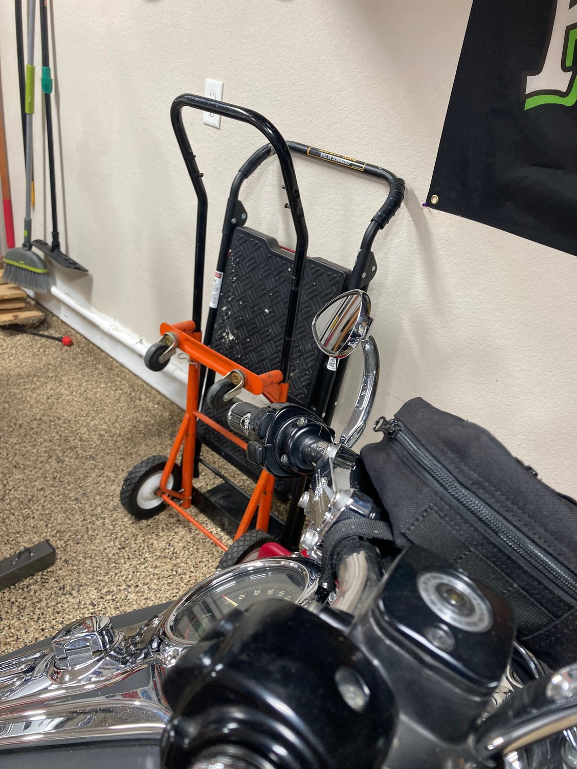

IMO it will work. I used the HD 3" pull back riser and added a 2" sportster spacer to get mine where I wanted them and theres plenty of cable and wire left. Total rise is 7.5" and 4.5" pullback.Pics will give you a good idea of where my bars are. Good luck and send pics when youre done.
