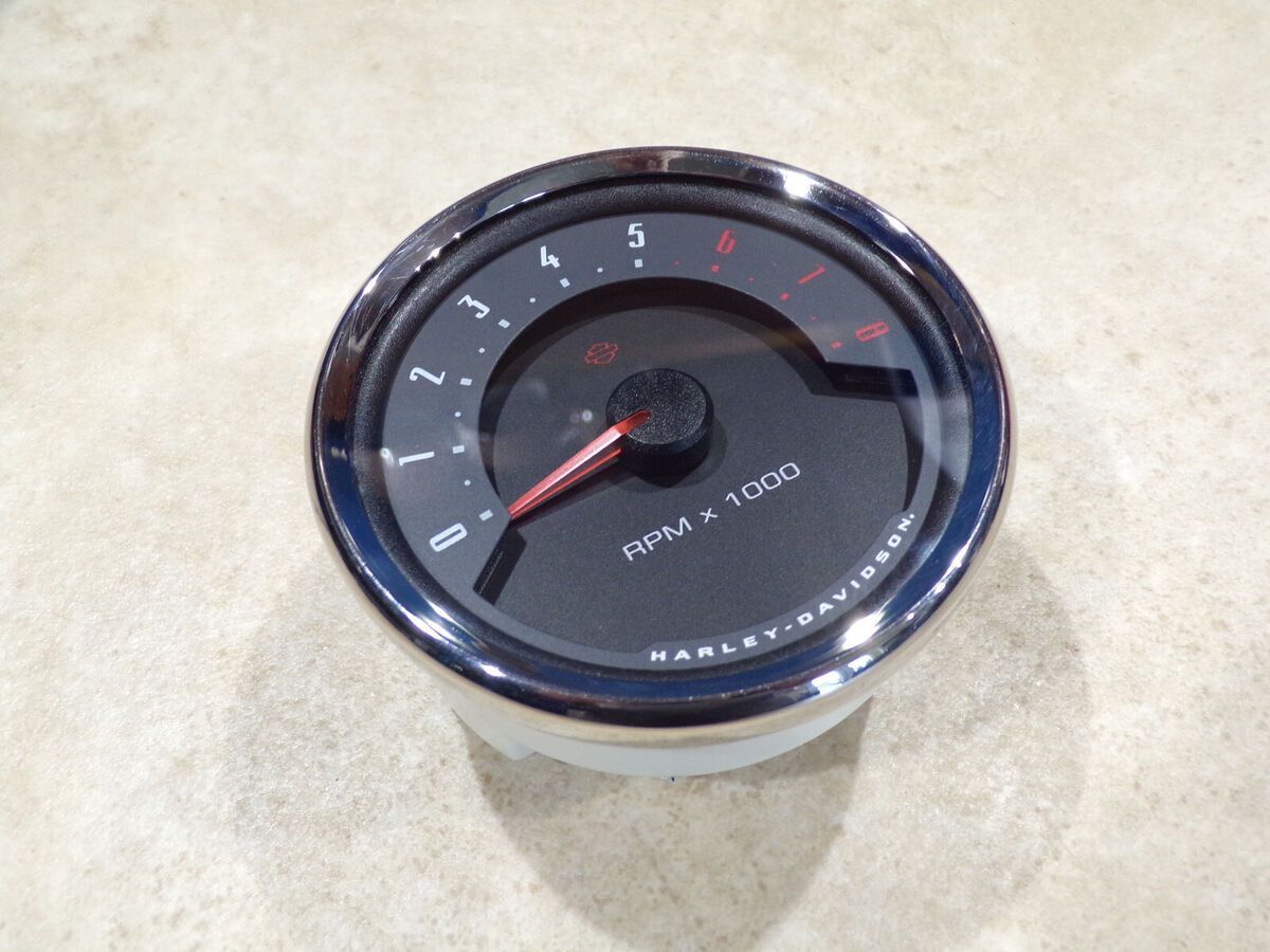

I am looking to relocate my speedo to the handlebar and also add a tach to my 2020 Softail Heritage FLHCS 114. Was wondering if the tachometer from a low rider S can be fitted to my bike, if yes, do I need a special harness?
Tachometer part no. 70900729B, i guess it is slightly smaller than the stock speedo as well?

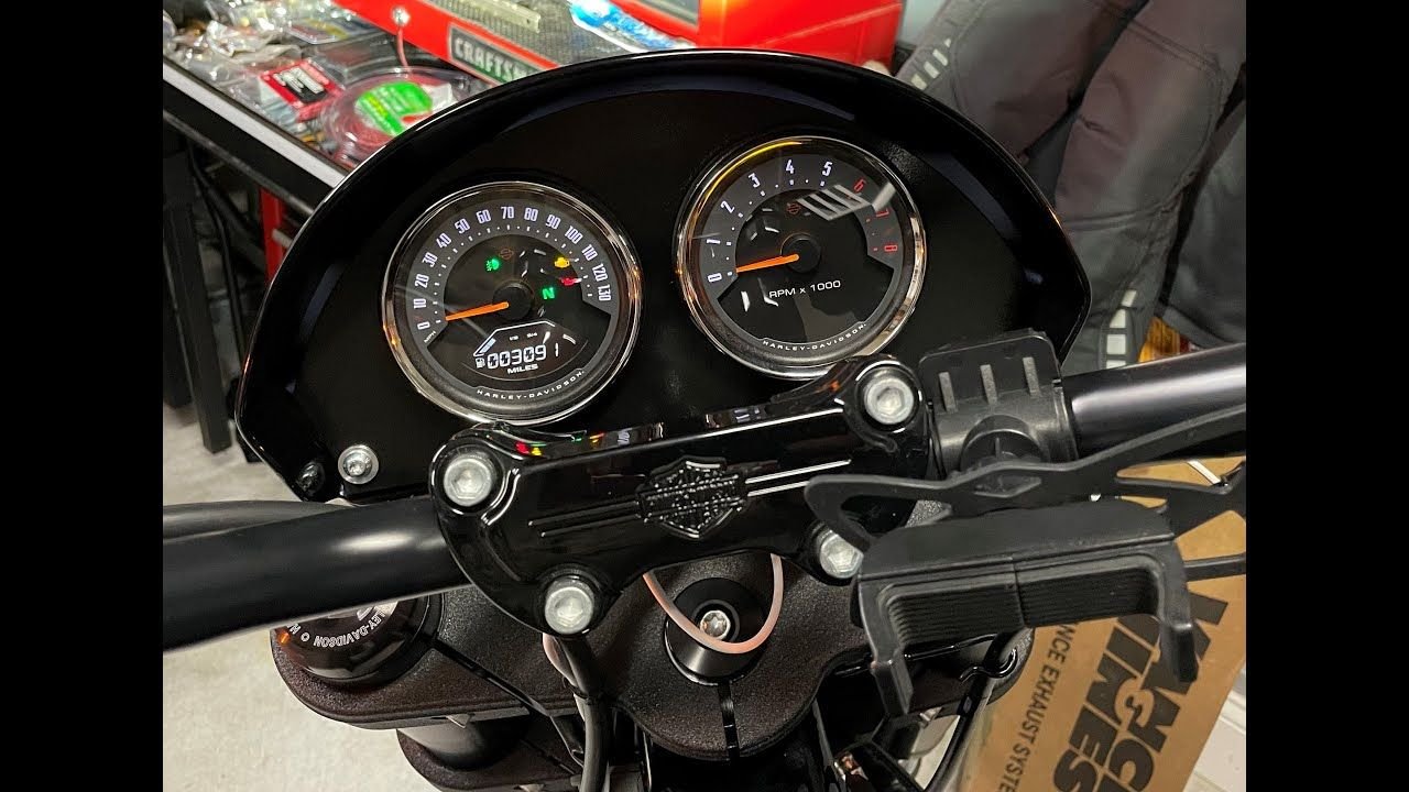

yeah the brackets are available, but cant find any info on how to wire in a tach to this bike... it uses a different harness for the speedo and would need data split to the tach. Would love to use the speedo and tach from a low rider since the warning lights are built into the speedo and i wouldn't need to look down on the tank for anything,
These are the gauges i would love to have on my bike.

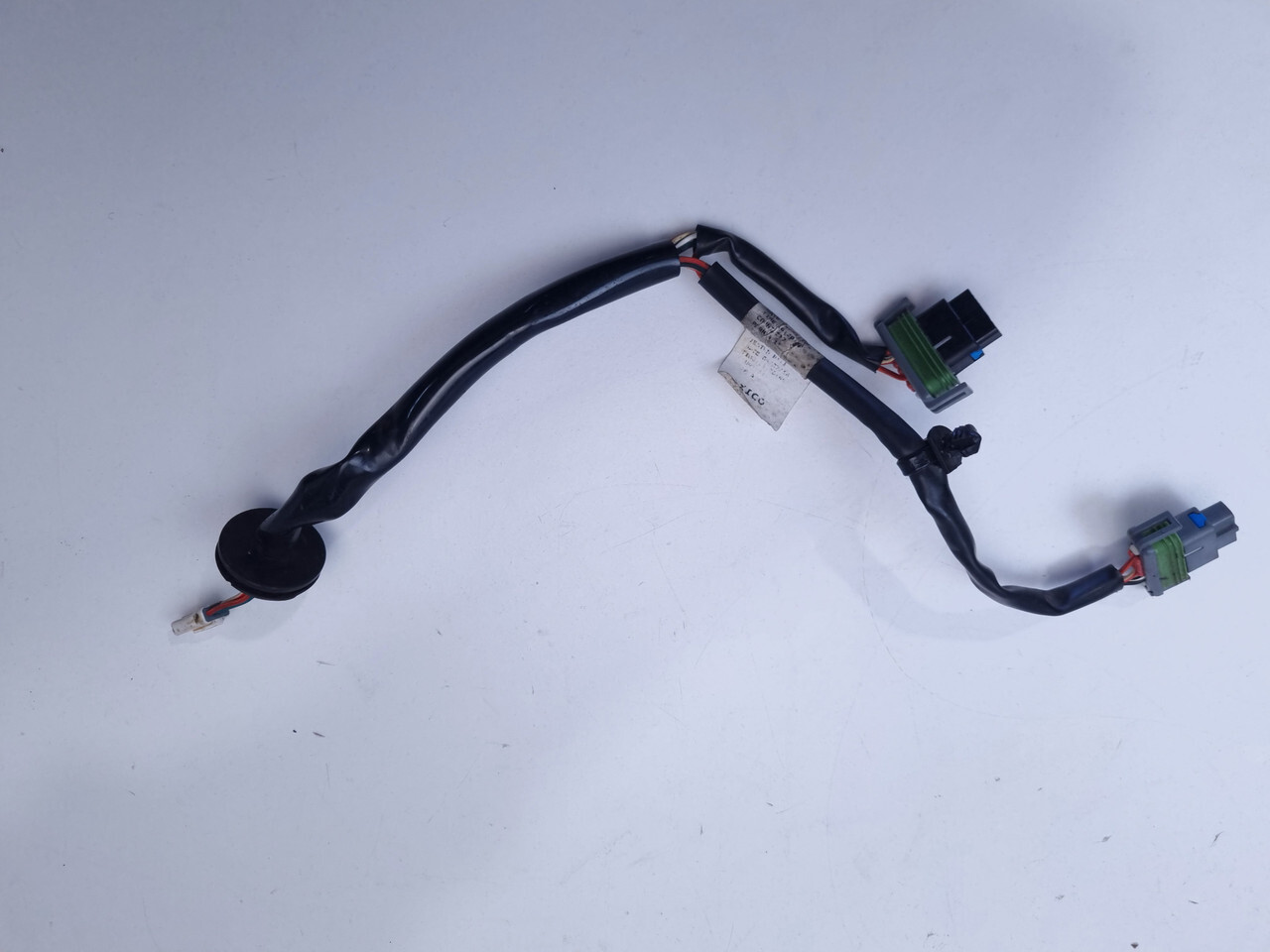

You will probably need 2 cables.
An extension cable from the tank to handlebar clamp. The aftermarket one I found is the "Namz speedometer and instrument extension harness NSXH-3201". They have multiple lengths. I got the 32" one which was way more than I needed for a 6 inch pullback riser.
Then you will need another cable that splits the signal to speedo and tach. Harley Davidson 69201611. Its the cable used on the 2018-2020 Low Rider with the dual gauges.
Here is a picture of the cable
https://i.ebayimg.com/images/g/fBkAA...b0/s-l1600.jpg
You will also probably want 12100109 Frame Plug to plug the hole where the wire comes through the frame to the tank mounted gauge.
There's also a single tach/speedo combo gauge that the later low rider S uses. If you go that route you'll probably just need the extension cable.
