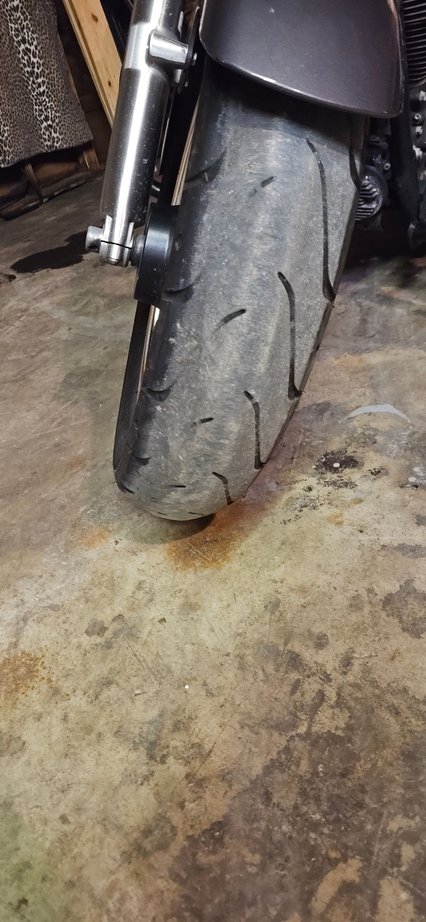

So my Front tire wore on one side. Really bad anyone got ideas on this and to why it's doing it.

Check your wheel bearings.

Looks like you enjoy taking right hand turns hard.

How does ride? Pull to the side? Compensating with steering?

I bought a used bike years ago that wore the front tire like that. Turned out it had been wrecked/repaired at one time & still had a slightly tweaked triple tree. Also, bent fork(s) can yield that same result.
