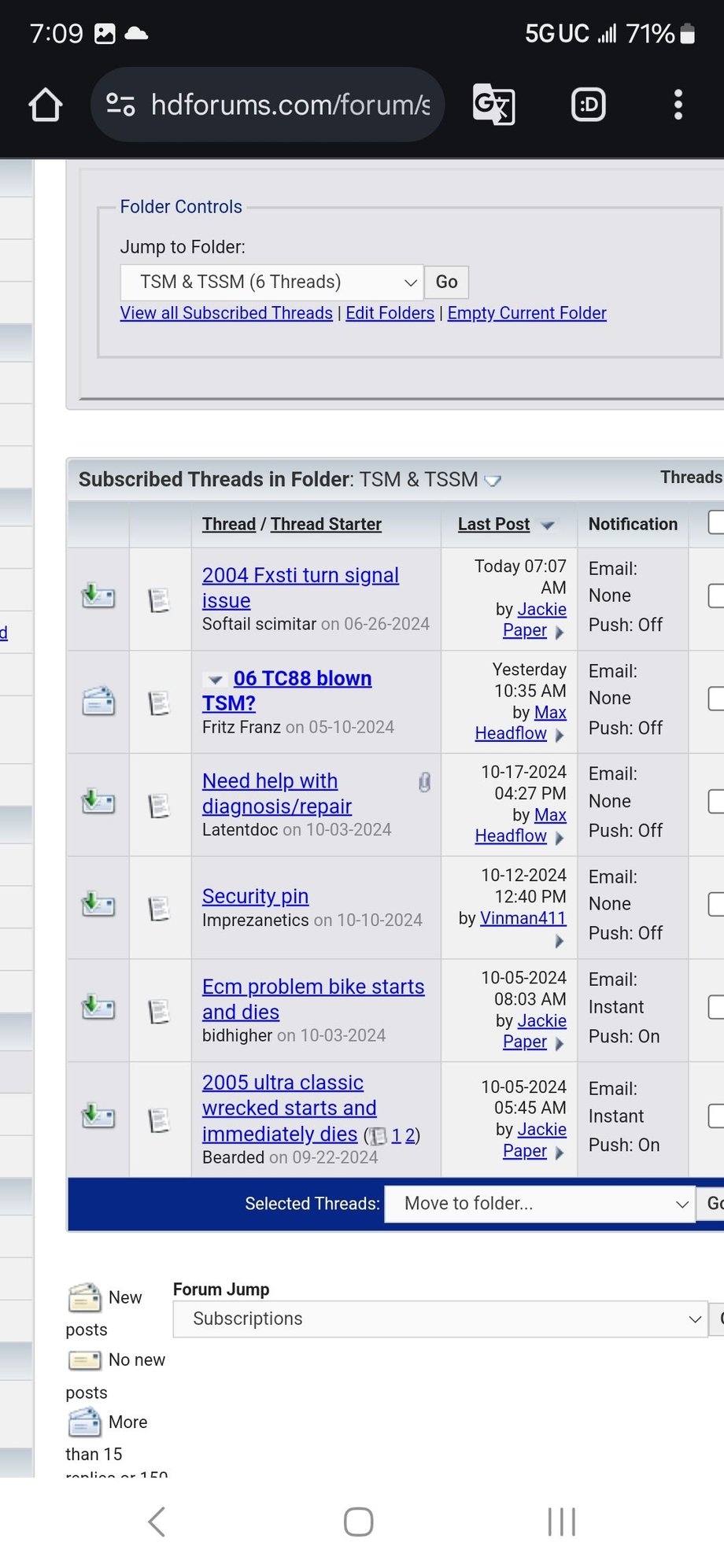

These older Harleys are a dieing breed simpley do to no parts for a electrical part on them. There have been numerous new threads on this issue.
This is the 6th I have added to my resources.
