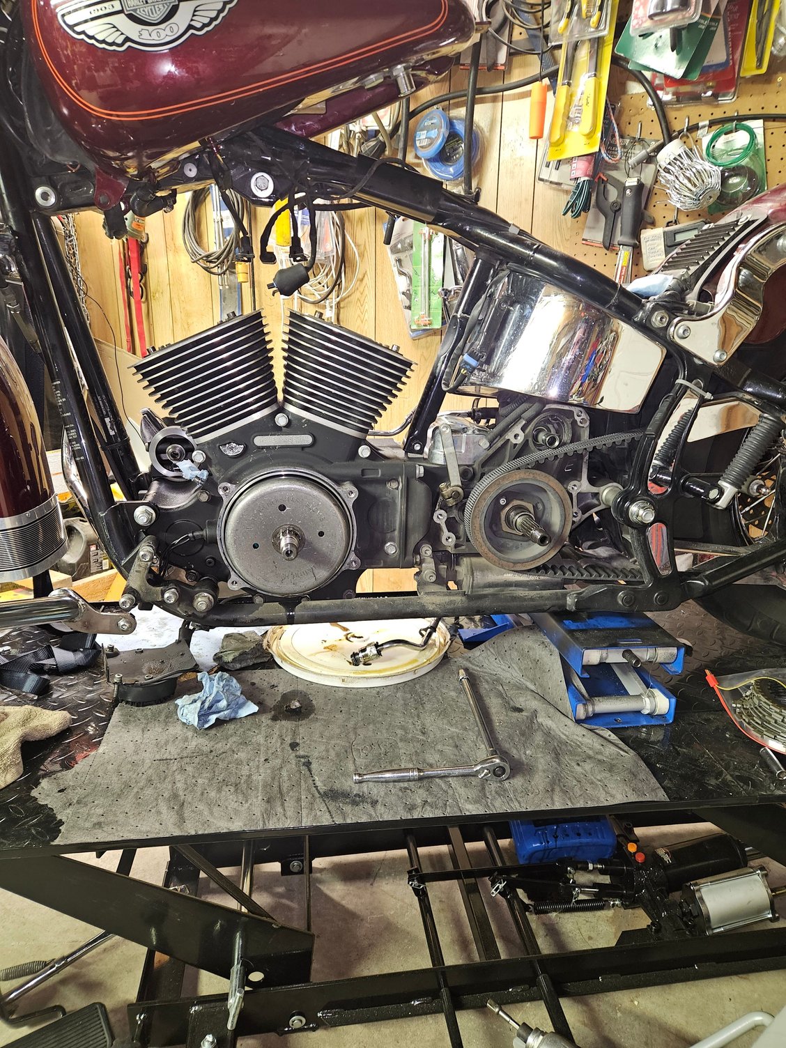

The book says transmission removed as well it looks like I can pull just the motor without touching the rear or transmission of the bike..probably just remove oil bag for flushing. from the mesument I got seem like a 96ci kit and the heads are definitely not stock they cut out the rocker boxs for bigger screaming Beagle spring clearance. I think I will have to replace crank hope the harely cranks can hold up the owner probably won't want to spend the big money for a darkhorse with the Shipping costs and the Canadian exchange rate .now I just need to check the stroke and verify it's not stock stroke

Call DH and ask them to ship you a box with all the packing. Just drop your engine inside and ship back. They will use the same box to get it back to you anyway so you pay for it up front.
