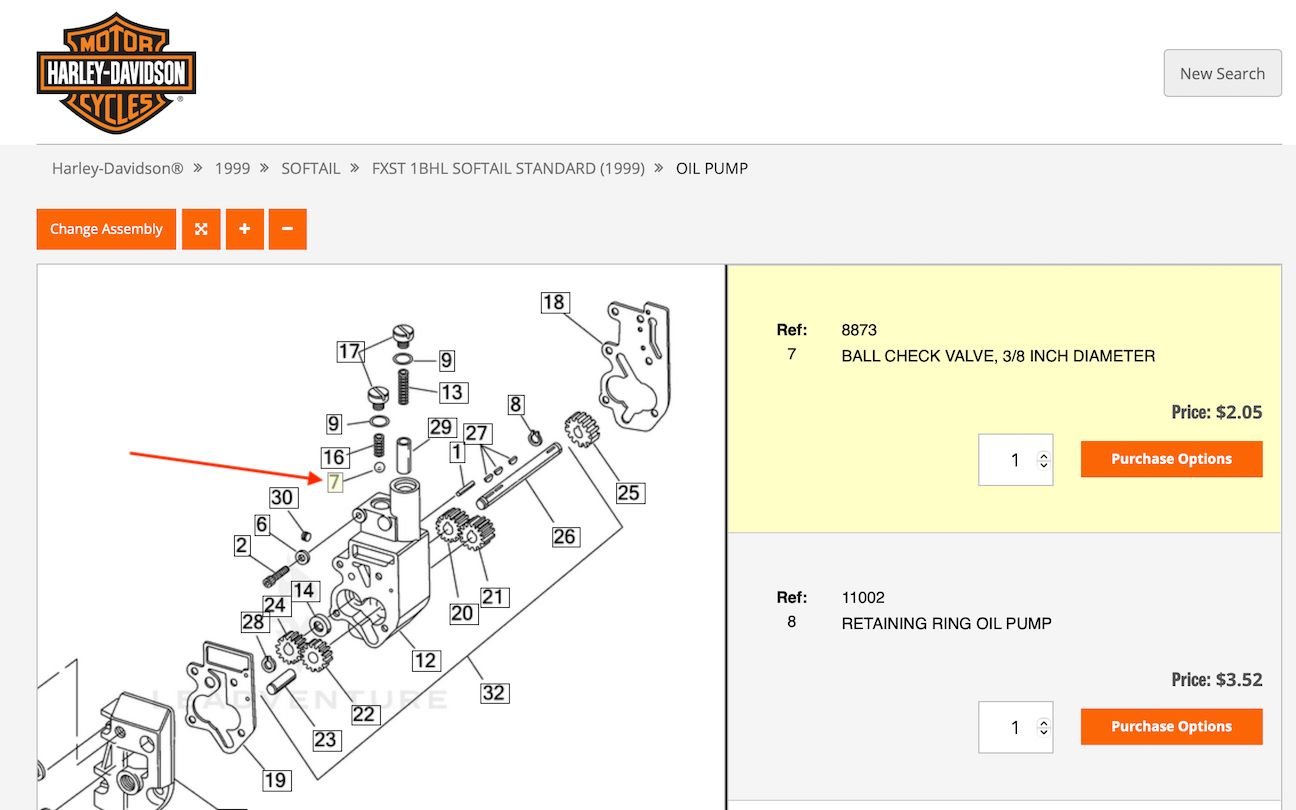

Old Dec 2, 2024 | 10:01 AM
hattitude's Avatar
hattitude
Posts: 14,064
Likes: 11,082
From: San Diego, CA
Originally Posted by Dseago1969
The oil was already overfilled from someone not realizing the tank to crank sump on this bike. I’ve drained about a quart or a little more off already and it’s still over.
FWIW...
Since you are new to this engine, the oil tank to sump, unlike the Twin Cam Engines, has a check valve to keep the oil tank from draining into the sump...
If your oil tank is draining into the engine sump, the check valve ball (#7 in the pic below) and/or it's seat has an issue... could be dirty, debris, damage, or wear....
Just something you'll want to address sooner or later while you getting this bike back up to good running condition...
Old Dec 2, 2024 | 10:05 AM
brakeless's Avatar
brakeless
Joined: May 2017
Posts: 5,915
Likes: 5,928
From: NorCal
FWIW...
Good point @hattitude. Also make it a habit to clean the Tappet Screen shown as #29 with every oil change.
