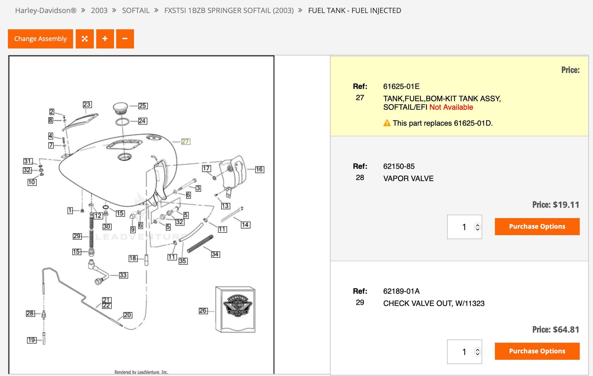

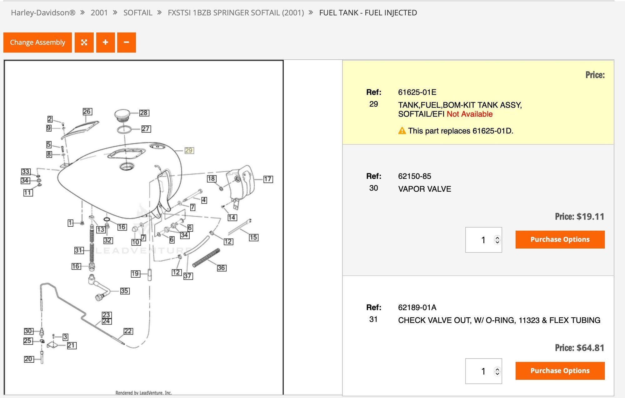

The 2003 EFI Fuel Tank is the same part number as the 2001 EFI fuel tank. It is part #61625-01E, which is no longer available. As long as you get the 2003 EFI tank, it should fit. The carb tank won't work for EFI as there would be no opening in the center to install all the EFI fuel stuff....
As mentioned, the carb tanks have no opening in the center of the tank. On the carb tank, the float level goes in via the left side fake gas cap, and the fuel petcock goes in from the bottom of the tank.
Here is the tank for the 2001 FXSTS w/carb, #62180-00D;
The EFI tanks have a big opening in the center of the tank to allow for the installation and removal of the fuel pump, fuel pump sock, regulator, filter and float level.
Here are the tanks for the 2001 FXSTSI EFI and then the 2003 FXSTSI EFI, both part #61625-01E:
I hope this information helps...
Good luck with your new tank...
