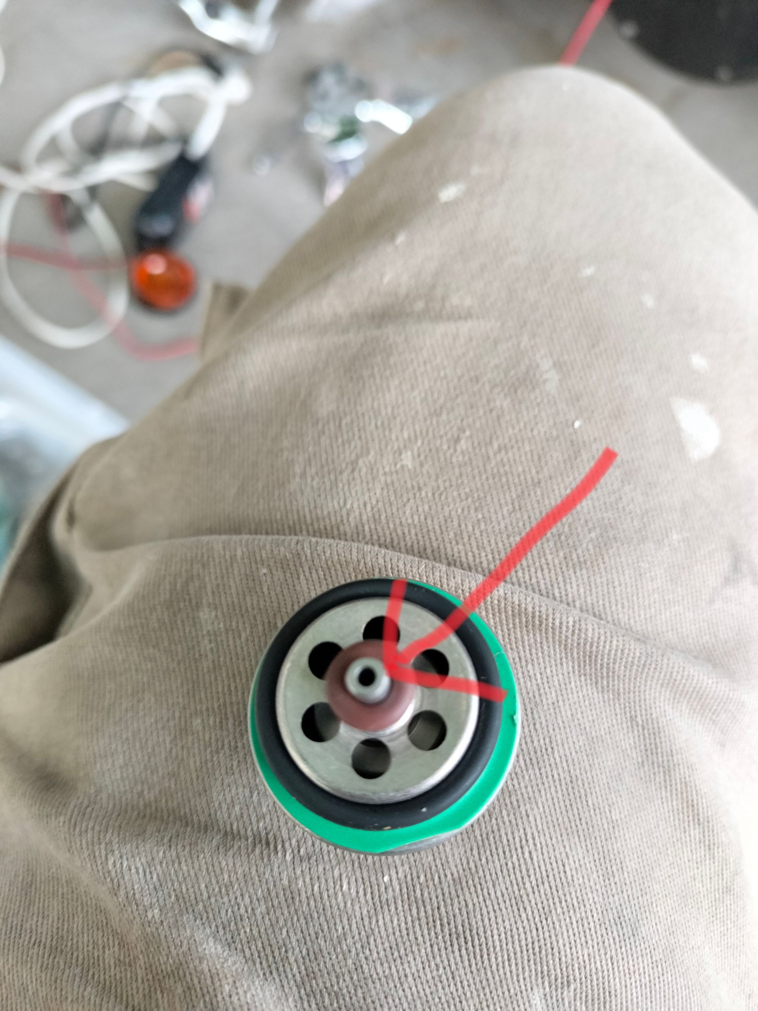

I have a 2016 Harley Fat
boy.
I recently had a no start issue and found that the fuel line inside the tank was leaking/broken. I decided to replace the fuel pump, lines and regulator while I was there. I put it all together but now the regulator purges all of the gas when I turn it on. I checked the fuel pressure and it has 55psi pressure for about a second then the regulator purges it all (sprays it into the tank, I can watch it).
I figured the new part was bad so I tried the old part. Same thing. So I ordered another new regulator and it is doing the same thing.
Any ideas?

Put the old regulator back in and see what happens.. The regulator in the pic appears to be missing some parts.. The screen is what supports the inlet O-ring..
