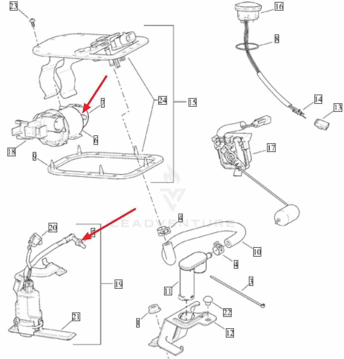

Originally Posted by MarlinSpike
Yes, the pump does not have a control itself. Check valve for back flow, I would bet to hold the pressure from the pump to the regulator and hold the set pressure.
But my point was - after three regulators it's time for plan B.
It may be the housing that the regulator is held in. If fuel is still spraying out after the pump has stopped for more than a couple of seconds, that is not correct, and would not be holding the set pressure. Meaning that the Housing interface or O-rings could have issues.
Could also be the fuel line to nipple connection - those lines and clamps are a little tough for some people.
I think the pump itself does not have a separate check valve. At least the early delphi ones didn't.. The pump was a flexy vane type and the way the vane flexed kept it from spinning backwards and sealed off the pump.

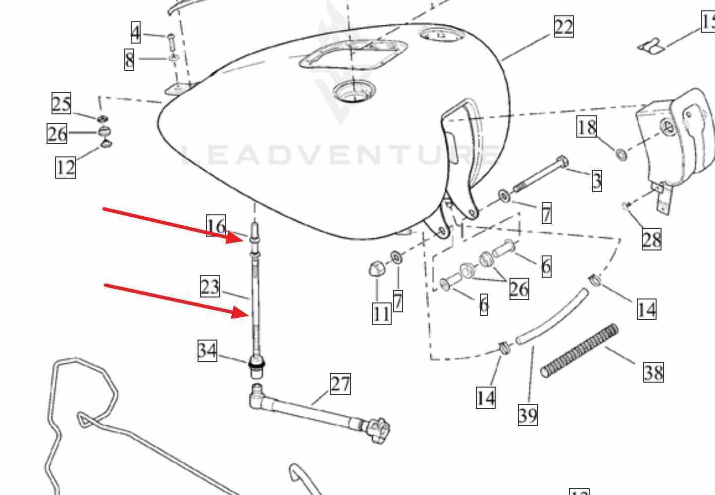

I just took the picture without the screen to show where I think it is coming out I know where the screen goes
But I'm thinking maybe there's a crack that I can't see grrr thanks
QUOTE=98hotrodfatboy;22050426]Put the old regulator back in and see what happens.. The regulator in the pic appears to be missing some parts.. The screen is what supports the inlet O-ring..[/QUOTE]
