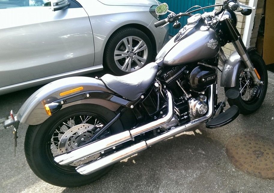

The difference between the Deluxe & Heritage are the length of the rear shock absorbers, they have the same front forks, so the Deluxe sits lower.
There is no difference on the suspension between the Deluxe & Slim, however the riding position of the Slim seat is further back, this is achieved by the riders seat & handle bar position.
If you look at a TC Deluxe the front of the seat goes up the tank & covers the rear tank mounting screw, the front of the Slim seat is much further back and the mounting screw fully exposed!
A lot can be achieved regards position buy changing seats, handle bars & risers.
Generally for Police, Ride Like a Pro, slow manoeuvring, 'they' get you to move as far up the seat to sit nearest the tank, so regards the example of the Deluxe & Slim, this is far easier and further forward on the Deluxe than it would be on the Slim.
