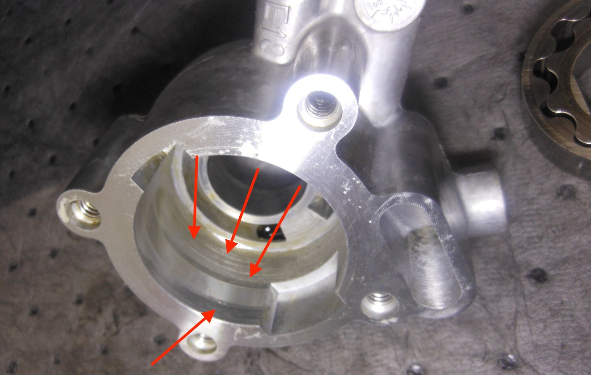

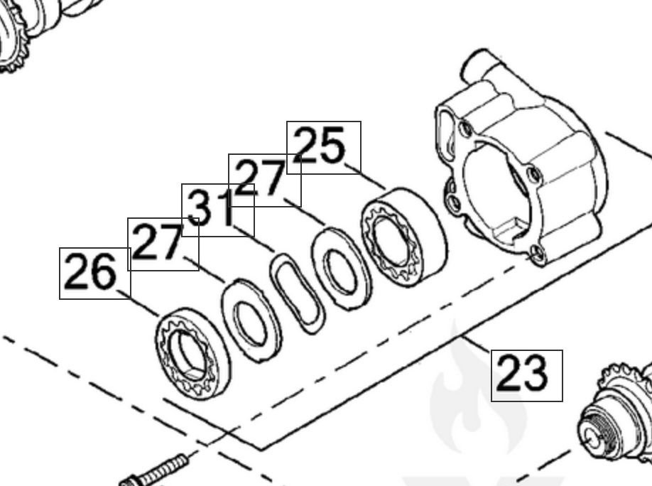

Make sure when you open the cam chest, to look at the inside of the oil pump.
Pull it apart carefully if you'e never done it, maybe take pics. There are two pairs of gerotors, 2 separator plates, and a spring separator (wavy washer) that need to go together in the correct order. Also, when reassembling the oil pump, the main o-ring on it that fits into the case needs to be installed properly. If it is kinked, or not fitted properly, the bike will sump. Easy stuff, just pay attention to details.
I mention checking the oil pump because it will show if metal pieces have gone through it...
On my friend's bike, his pinion run-out measured 0.0025", which is excellent. It wasn't until I looked into the oil pump that I discovered he had a serious problem..
There will be signs of wear on the oil pimp, but scratches that are deep and easily felt with your finger nail are a sign of a problem... It means something other than oil has gone through the pump
