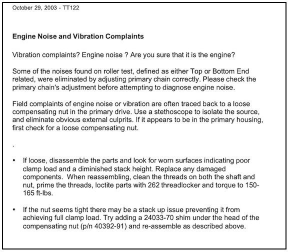

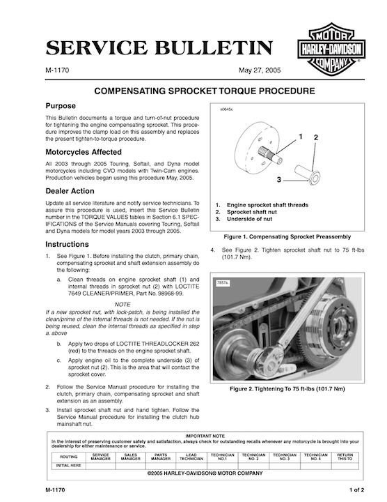

Loose compensator bolt make some exciting noises.
Old Jun 26, 2025 | 01:34 PM
  #36
hattitude's Avatar
hattitude
Posts: 14,160
Likes: 11,249
From: San Diego, CA
Good point...! And the Op's model/year fall into the range of bikes covered by the comp nut torque change, and loose comp bolt .
OP, take a look at Service Bulletin M1170 Compensating Sprocket Torque Procedure (dated 5/27/2005) and Harley TT122 Engine Noise Vibration Complaints (dated 10/29/2003).
TT122 deals with a loose comp nut or one that fails to achieve full clamp load;
Service Bulletin M1170 basically changes the comp nut torque procedure from a torque only spec, to a torquing the nut to 75 ft lbs, then adding and additional 45° to 50° turn to the nut. They say 50° is the maximum to add.
