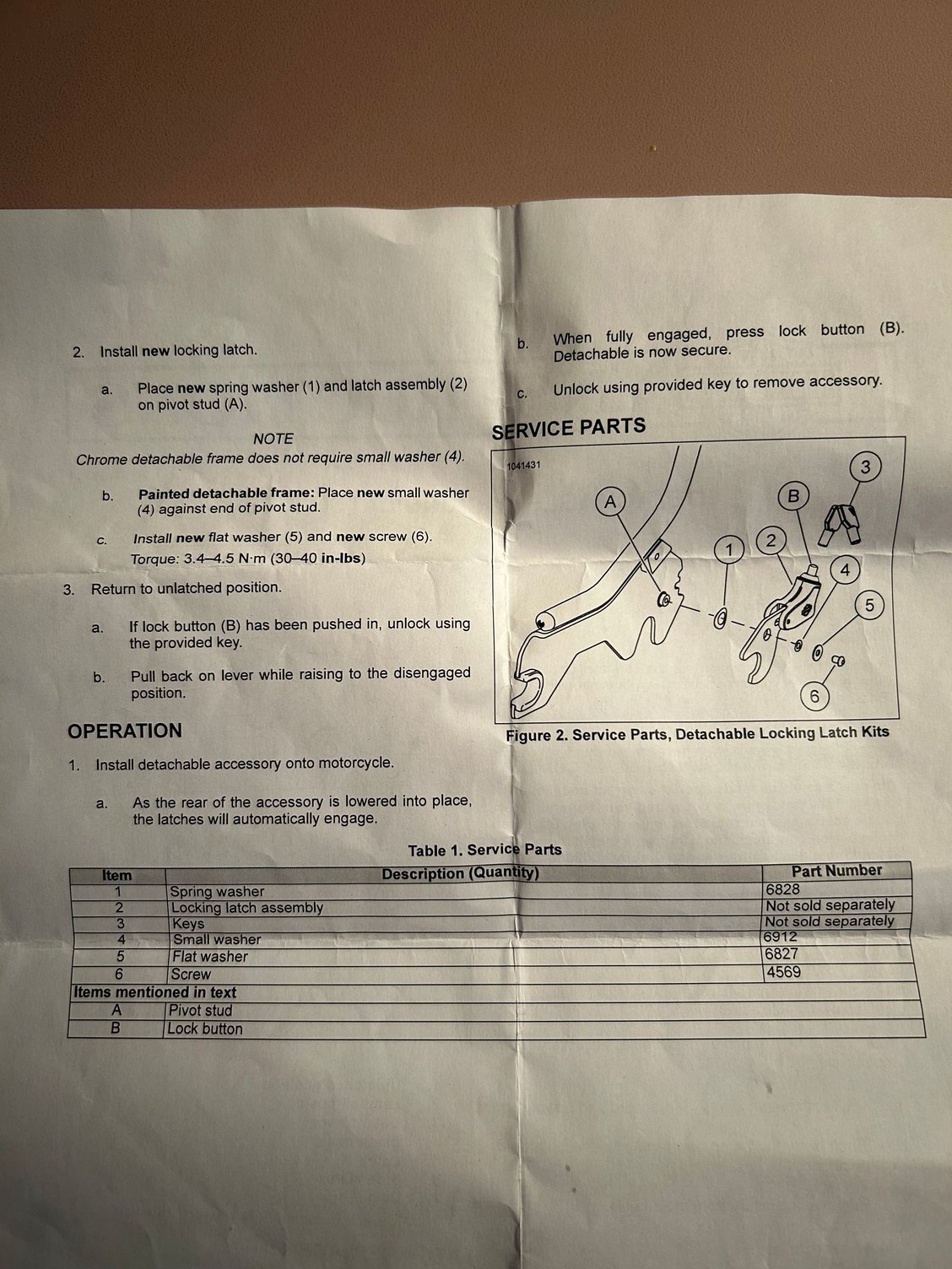

One of my Holdfast detachable sissybar latches has fallen off. I'm hoping someone has one available or an idea to find one.
Harley sells a locking latch but does not include all the parts needed to complete the replacement.
Photos show part I need.
Thanks in advance.

Bone Doc, thanks your reply. Bike is a 2020 Heritage Classic.
I have Google searched both by text and photo search. Same with Ebay.
I may be wrong but I believe the Holdgadt line od accessories cover several models.
The part missing from the HD locking latch I believe to be the bushing nut which is pictured below.
Thanks again.

Looks like you need A, pivot stud. I have two right side original latches that I replaced with locking latches plus #s 1,4,5,6 but no extra pivot studs.Doesn’t look like HD has that as service part. Odd. Any of the above you can have but don’t think that helps. Did you lose latch too? Maybe try a shoulder bolt and nut on the inside if there is clearance w/fender. Sucks cause detachables are expensive.

Softaildale, yes I lost entire latch assembly. I wonder if I could improvise with one of your spares?

If a right hand side original latch in black will help, I will send you one, I will ship tomorrow. I will pay shipping cost , you make a charity contribution.
PM me an address.
