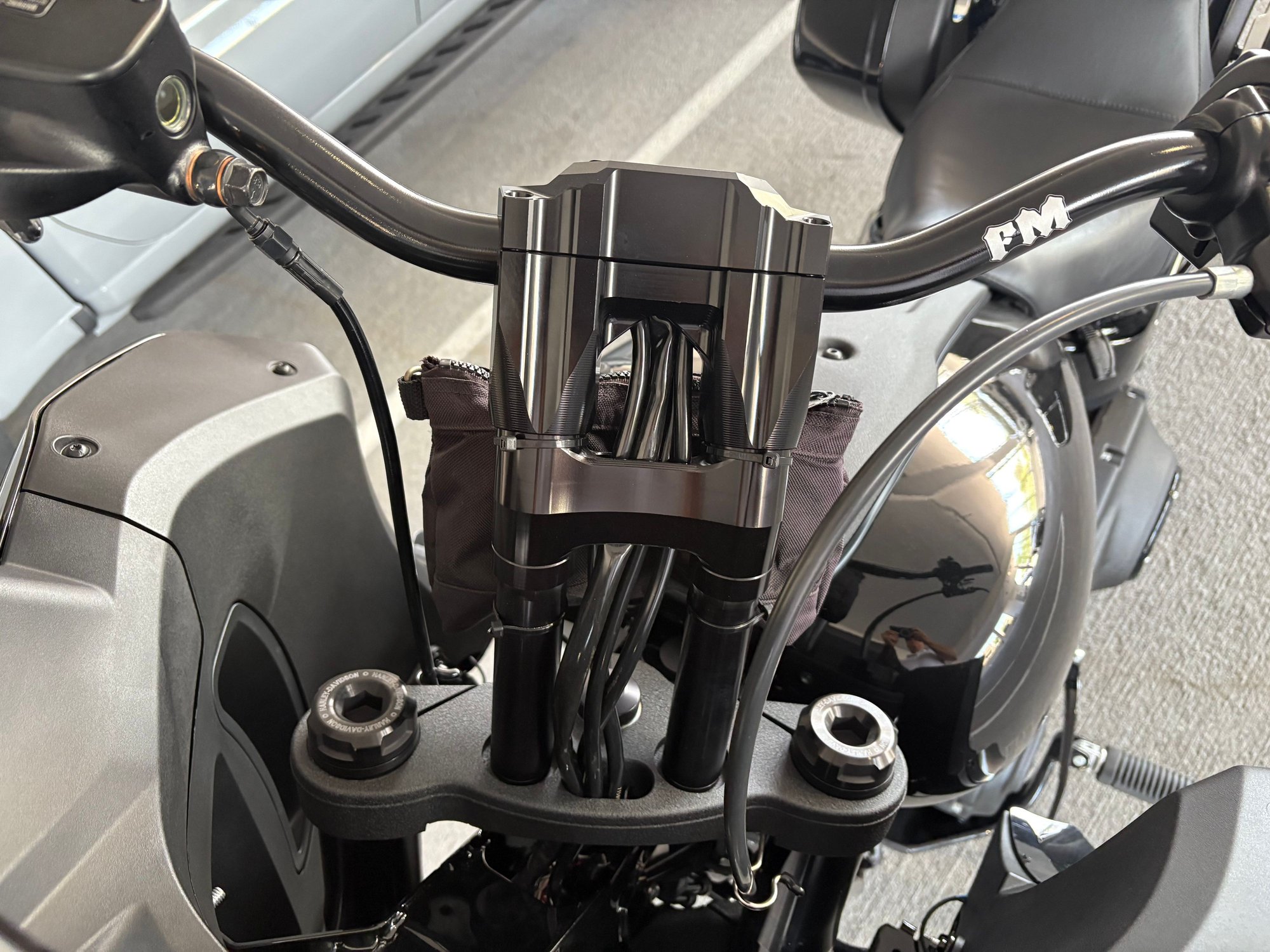

Anyone getting excessive mirror vibration to your bars? The mirror distortion is pretty bad….
I have a 24 Lowrider St w/
- Kraus 10” isolated pullback risers
- Arlen Ness mirrors
- Fly FM Moto Bars
- solid bushings
Should I change to Polyurethane bushings?

yes try changing bushings, did they vibrate before changing the bars etc

it could be a loose engine mount(s), the bike should be under warrantee still, take it back to the dealer see what they say, they will probably blame the new bars though, do a search on this forum as the vibration problem has been discussed before, nice ride by the way

Is the vibration at idle with the front brake on? Is this your 1st HD?

Definitely check for any loose motor mount bolts. Poly bushings are probably better, but either way make sure the riser bolts are torqued to spec.
