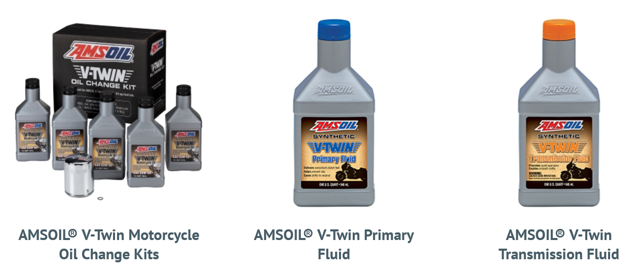

Yup, 3/4 turn... Harley transmissions have always had the distinctive clunk, type of oil/fluids may reduce the noticeable sound but never completely eliminate. I prefer Amsoil, smooth shifting, engine runs quieter, etc., maybe a little more pricey but money well spent. In my opinion...
