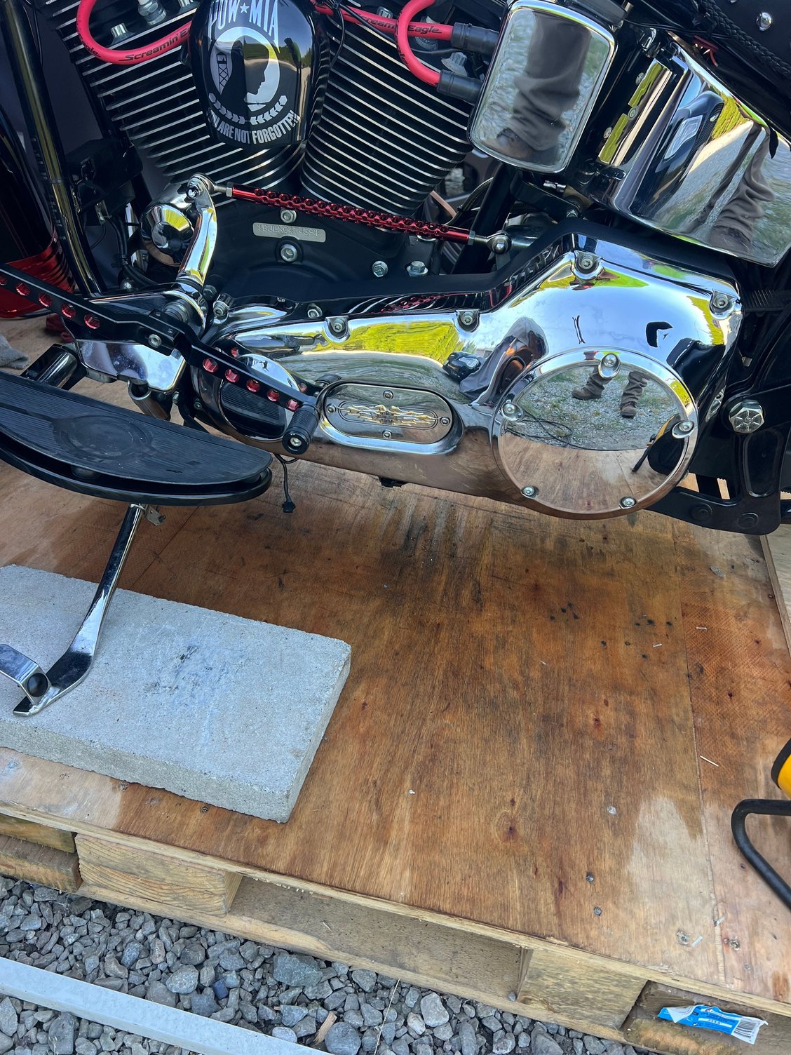

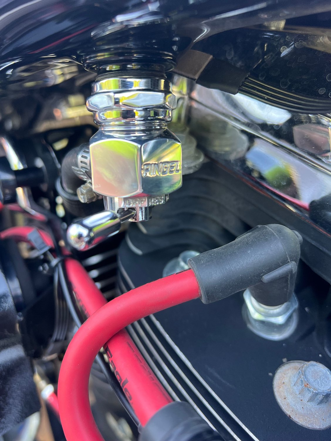

Switched to a mechanical Pingel Power-Flo the other day… didn’t even think to switch it off.
came home from work the following day to this:
luckily, it didn’t fill the case, just had a bad float seat and about half a tank went out the overflow.
took the carb off, cleaned it up, set the float to the proper height (because it was WAY off) and now she runs better than ever and no leaks!
still getting used to flipping the petcock though, really need that muscle memory to set in because I went to ride today and made it about 200ft from my driveway before it just died causing me to go “Oh… right… *flip*…” lol
