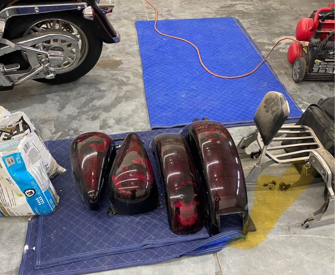

Are you sure those custom painted parts are for that year?

As far as the extra tins, I have no idea without looking at them. Honestly, I wouldn't run them anyway, I prefer the factory tins. But it would be nice to know what they fit so I can possibly sell them. Likely not for much.
