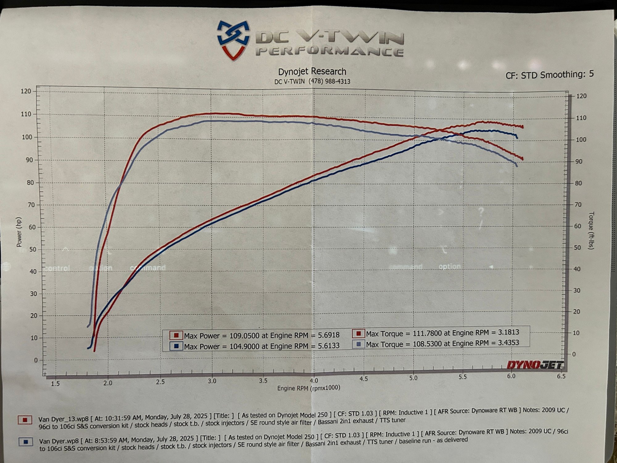

I went from 96” to an S&S 106 by adding the S&S 106 Hot set with 585C easy start cams.
With the exception of the S&S flywheel, and SE chisel air intake, the rest of the engine is stock. My exhaust is a Bassani Road rage B4. It does not have crazy power but it is well tuned.

There is one thing that I did not do. I didn't get a base map.
What I did was get a TTS Master tune for my bike. The Dyno Technician did the rest.
