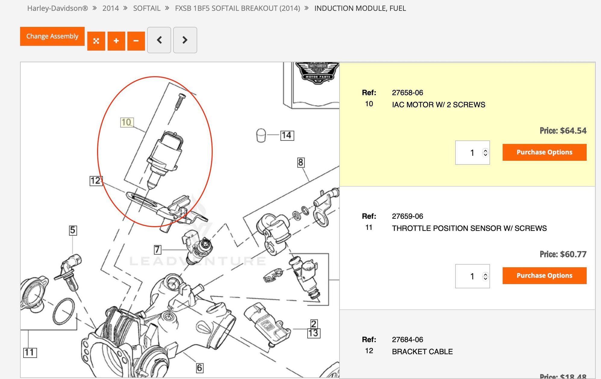

I was surprised to see your 2014 still has an IAC (idle Air Control) module. I thought they had switched from those by 2014... must have changed on just the touring "A" Twin Cams.
A bad or dirty IAC will cause your bike to stall as reported, and have hard starting issues. I don't recall it causing the bike to completely fail to start....
In any case, that's where I'd start with your reported issues. You can clean the plunger and its seat in the induction module that controls air at idle. You can also check to see if it is functioning altogether.
A quick search on this forum, or a general internet search, will give the directions for a cleaning and/or operations check. Both pretty easy...
Report back what you find...
