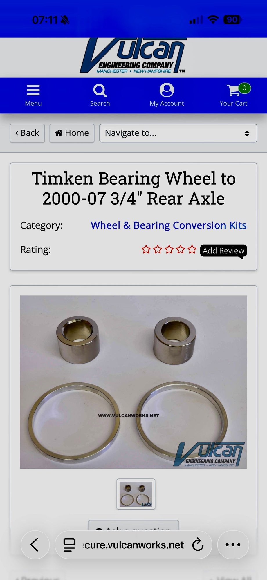

You can't use the #9267 3/4" Sealed Bearing in that new-to-you 99-earlier Tapered Roller Bearing wheel. The sealed bearings have a larger OD.
Originally Posted by Triunphscrambler
... I have now ordered at set of spacers which will hopefully fix this with a bit of work.
Does that "Set" of spacers contain 3 spacers?

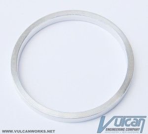

If you are going to reuse your 2002 pulley/sprocket (also if you going to change to your brake rotor), you may want to use a bushing like this
https://secure.vulcanworks.net/store...pter-Ring.html

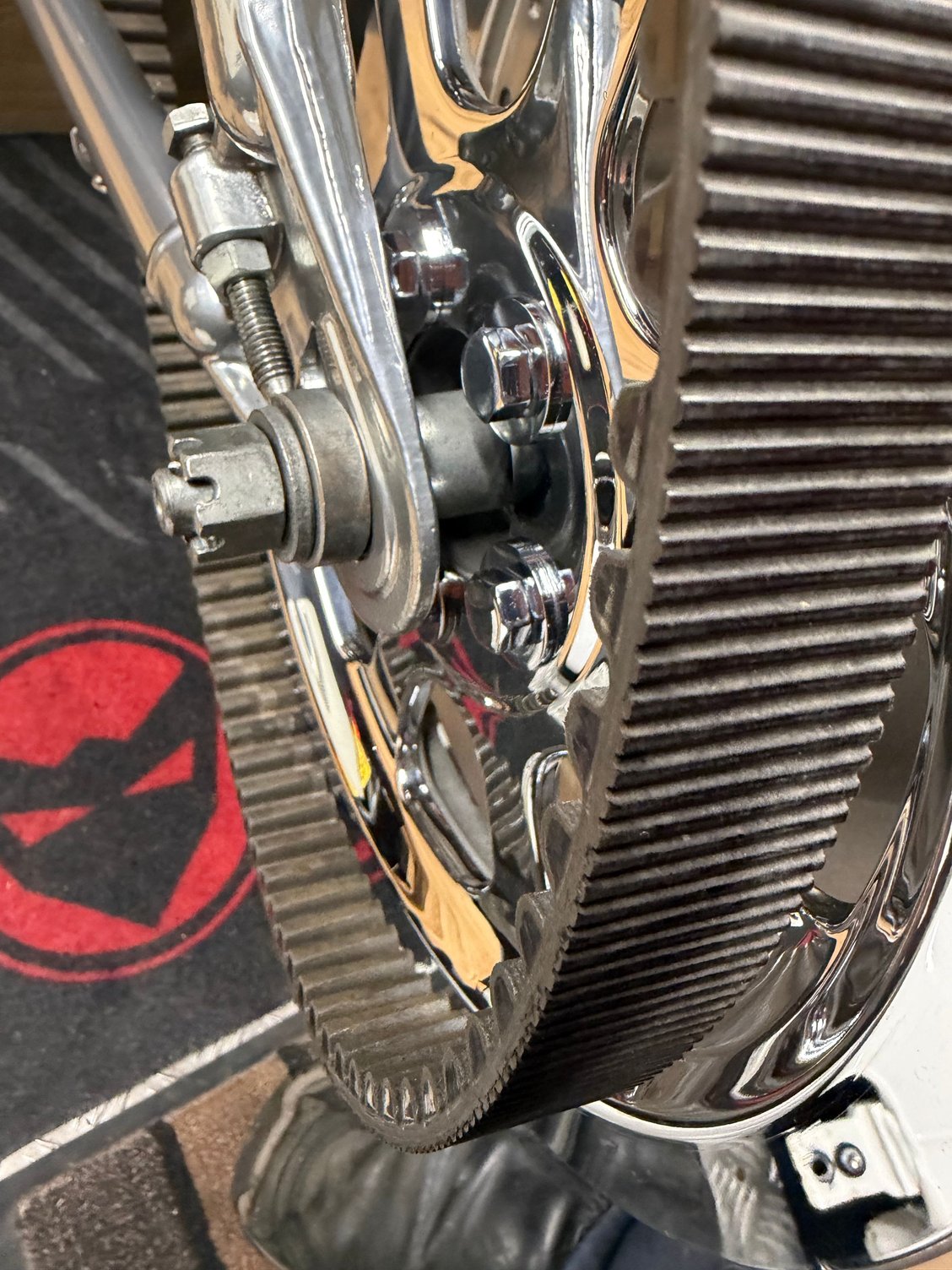

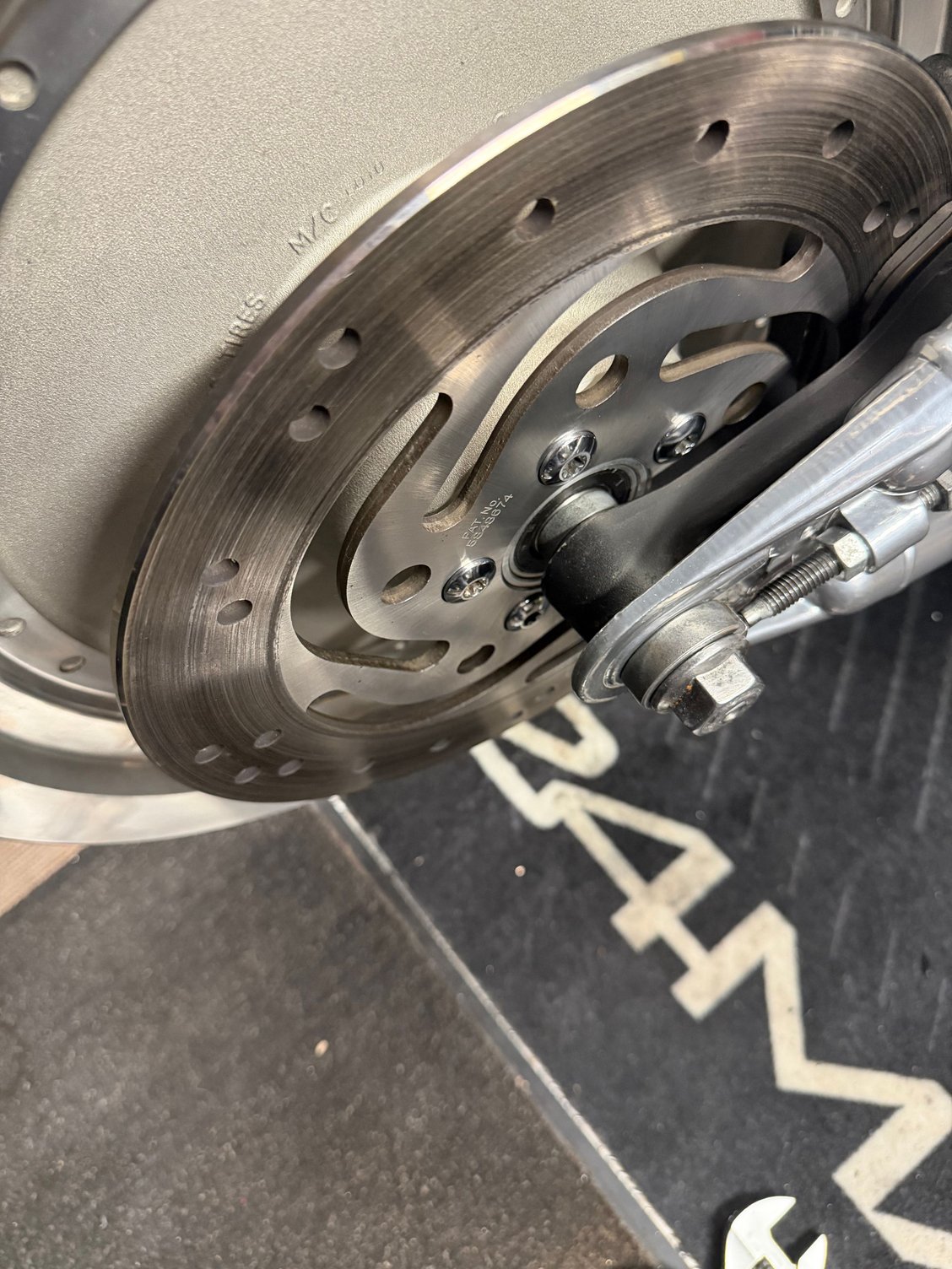

Hi guys, I’ve checked my axel and it’s 3/4 and the Timkin bearing wheel is 3/4 so I’ve ordered this kit from Vulcan which I’m hoping will do the trick
Old Jan 9, 2026 | 04:01 PM
Triunphscrambler's Avatar
Triunphscrambler
6th Gear
Joined: Jan 2026
Posts: 10
Likes: 5
Good evening guys, got the wheel fitting kit delivered today and it works really well, so simple but very affordable and effective. Thanks to everyone for chipping in and Multihdrdr for putting me on the correct path.
