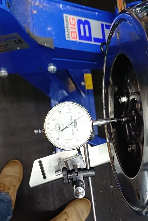

Originally Posted by Gomer
Great write up SJC69, thanks for the first hand input.
Mueller want you to start out with the ***** almost fully seated in the bottom of the ramps (1/8 turn out on clutch hub nut). I found I had more pressure plate travel with 3/4 turn out moving the ***** starting point up the ramps more.
My results:
all with 1/16" lever free play
- Clutch Hub Nut 1 turn out = .066" pressure plate travel
- Clutch Hub Nut 3/4 turn out = .066" pressure plate travel
- Clutch Hub Nut 1/2 turn out = .064" pressure plate travel
- Clutch Hub Nut 1/4 turn out = .062" pressure plate travel
I ran through the Clutch Adjustments again with Muller 2.0 as above on my 2016 TC 103, theses were my results with various settings of the Adjuster, basically no real difference as to lift and adjuster screw position.
I set the dial gauge up and basically use the too washers on the floor board as Go/No Go to set the cable free play at the handle bar to get some consistency.
My results were as below, all with 1/16" lever free play.
- Clutch Hub Nut 1 turn out = .054" pressure plate travel
- Clutch Hub Nut 3/4 turn out = .052" pressure plate travel
- Clutch Hub Nut 1/2 turn out = .052" pressure plate travel
- Clutch Hub Nut 1/4 turn out = .052" pressure plate travel
- Clutch Hub Nut 1/8 turn out = .054" pressure plate travel

Right I fitted the third of the Muller 2.0 clutch ramps, this time to my 2018 year M8 Deluxe.
I had previously replaced the clutch ramps from the original 19 to the 21 degree.
Before I started the replacement I checked the clutch plate lift with the 21 degree ramps and stock lever:-
- Clutch Hub Nut 1 turn out = .08" pressure plate travel
- Clutch Hub Nut 3/4 turn out = .08" pressure plate travel
- Clutch Hub Nut 1/2 turn out = .09" pressure plate travel
- Clutch Hub Nut 1/4 turn out = .09" pressure plate travel
I then installed the 2.0 ramps and followed the Muller instructions and adjustments to set the screw to 1/4 turn out and the cable slack to 0.06" (1.5mm) with the addition of an adjustable Oberon clutch lever now fitted and set to the span setting 4 which Oberon say is near to stock lever span.
(I believe span setting 4 not to be correct as equivalent to the stock lever span on the M8, it is more like position 5 or 6 of the 8 positions, otherwise there is insufficient travel/movement to operate the clutch switch)
I set up the DTI and checked the plate lift.
Muller Specify minimum travel of 1.6 mm ( around 0.65") at the adjustment screw when pulling the clutch lever
I achieve in lever position 4 around 0.055" (1.4mm) and needed Lever in span position 6 to achieve the 0.65" (1.6mm) plate lift.
For reference at full span, lever position 8, 0.07" (1.80mm) was achieved.
I was happy with setting at lever position 6 and it met the specifications of the Muller 2.0 set up, what I would say is with adjustable levers, when changing the span this will have a direct effect on the plate lift and needs to be considered!
