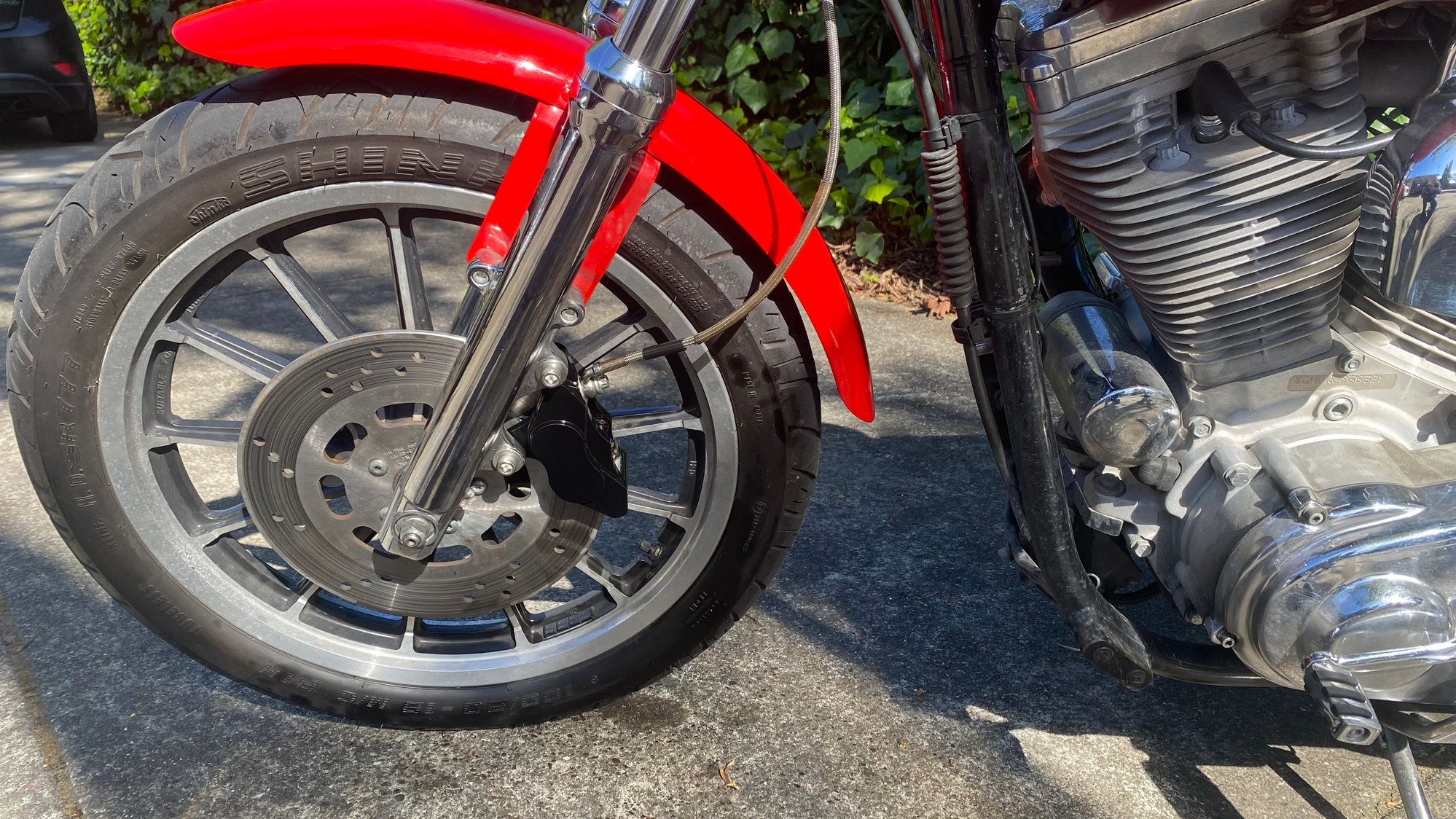

If the front brake still has the lousy stock single piston caliper retrofitting a four piston Wildwood caliper will make a big improvement in stopping power. About $250 from Summit Racing (and elsewhere)

I appreciate it. And yes, the front brake is definitely in need of an upgrade. It is not very confidence inspiring to say the least.

I agree that a Wilwood caliper is your first upgrade. Big difference, low money, easy install

I would buy off market place later style 4 piston OEM Harley brake calipers (I believe those are bembo) and I’d buy off eBay the bracket to adapt them to your forks.
